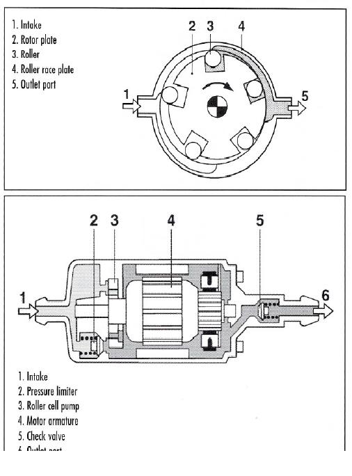

    It does help cool it but I've never understood how that fact can extend to running it low can really increase the temperature all that much. I googled and lots of people talking about this but I saw nothing that concludes with real evidence one way or the other!

    illinois
    Most vehicles these days have electric fuel pumps located in the gas tank. By keeping the tank over half full the fuel pump electric motor is cooled by the gasoline. Also i don't want to suck the gunk at the bottom of the fuel tank into the filter or injectors.Maybe i'm lucky but last 6 vehicles our family had all went over 100,000 miles and never replaced a fuel pump or starter (synthetic oil )easy starting in winter. The chevy actually had 160,000 miles when replaced.

    Some (I'm pretty sure nearly all) in tank automotive fuel pumps are cooled directly by the fuel being pumped through them, motor and all.
