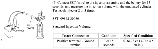

    Yeah, a bad resistance reading on the injector coil would tell you the injector coil was bad. But a good resistance reading only tells you the electrical coil isn't bad. The injector mechanically could be totally kaput.
    The way to check that is to take it out and attach a pressurized fuel line and check how it injects fuel.

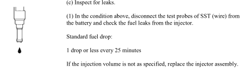

    You're checking both that it injects the right volume of fuel when turned on for a given amount of time:
    and (probably more to your point) that it leaks no more than the specified limit when turned off:
