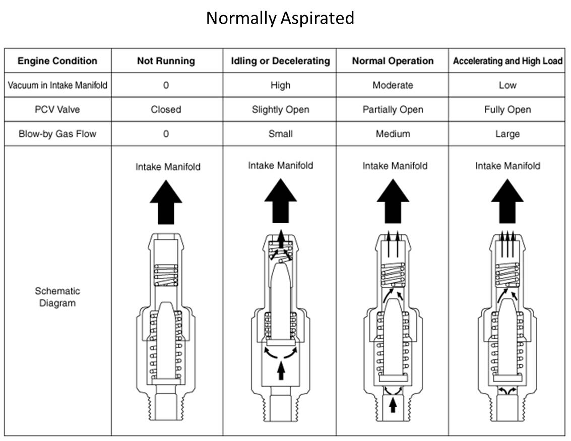

    Something I'm realizing is that with a horizontal PCV valve, it will only ever close during a backfire. Vertical PCV valves will close when the engine is off due to gravity. If there's pressure in the crankcase, it will open a vertical valve even with the engine off. BUT...I wonder if having a horizontal valve that stays open during engine off allows more vapors to flow from the crankcase to the intake compared to a vertical valve.

    PCV valves have an internal spring that keep it closed up to some pressure threshold, regardless of orientation I think.

    Not the supposed OEM one I just received. When I look at it on its side, the little plug bit is slid away from the engine-side opening. When I turn it vertical, it is closed. Maybe it's defective?

    I’ve never fully got my head around it, but I don’t think orientation should affect its operation. Here’s a wiki article:
    Crankcase ventilation system - Wikipedia
    And if you search for the text string:
    The PCV valve controls the flow of crankcase gases entering the intake system
    it goes into details about what the valve does, under varying intake manifold vacuum conditions.

    So a PCV valve can close (or almost close) in both directions, both under high vacuum and under backfire or engine-off (if gravity assists it). Look at this. With a horizontal PCV valve the condition on the left never happens.

    I’m not sure. Looking at the leftmost pic, the “bullet” shaped internal thing looks to be encased in a spring, that could keep it pressed against the bottom opening, regardless of orientation?
    Granted though: the one you pictured seems to flop open/close easily.

    Right, that's what the picture shows but not what the PCV valve in my hand is doing. It only does the leftmost situation when oriented vertically. Anyway, maybe it doesn't matter. Maybe the crankcase heat creates enough pressure during engine-off to still push vapors past the relatively loose bullet. I'm sure that's intentional (whether well thought out is maybe another thing).

    That’s a brand new Toyota PCV valve? Maybe defective?? It’s very infrequently I’ve got one in hand, but it seems to me they’ve always had a metal bit right behind the internal opening, firmly enough that orientation didn’t matter . Could be “creative” recall on my part.
