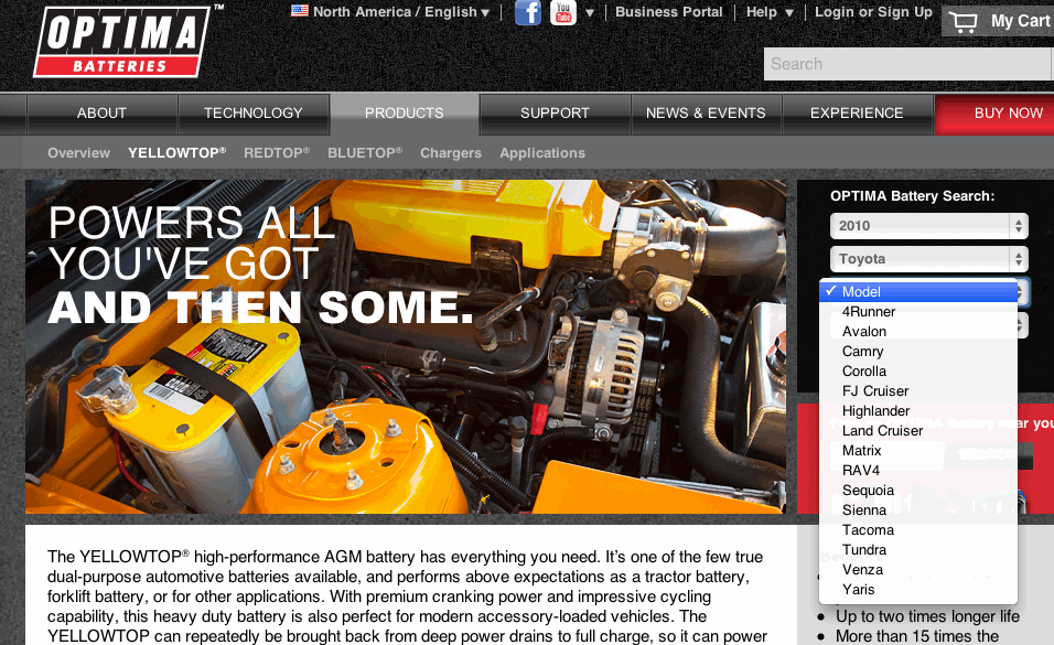

    Is it just me, at Optima's own site they don't even list a Prius as a model by Toyota?

    ^ Probably. Yes, that's buried. Still odd that they'd completely ignore a popular model name series in their drop-down finder widget, for all the model years they've been selling a 12v battery for Prii. So 2004+ includes 2010-2014 also? Or is that one aimed at the 2004-2009 GenII's? Is there a difference in specs for GenII and GenIII batteries?
