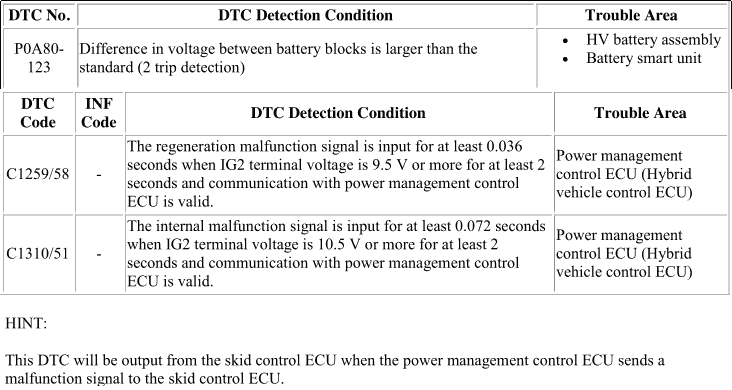

    I made this image for another thread, glomming together bits of different pages in the manual. Never mind the P0A80, we don't know that's your code yet. But look at the detection conditions for C1310 and C1259.
    Notice that each one requires that "communication with power management control ECU is valid". (Emphasis mine.) So it is not a communication error, it is straight up valid communication with the PMC ECU, and the PMC ECU sent actual messages to the brake ECU saying "hey, I'm having some internal issues affecting regen, you're going to be on your own for slowing the car down" and the brake ECU sets those two codes to confirm it received those messages.
    The key is going to be to find out what code(s) the PMC ECU has, which will be the reason it sent those messages. If what you're using to read codes is only showing you those two in the brake ECU and not the code(s) in the power management control ECU, you're going to need something better to read codes.
    Once you know what the power management control ECU is actually complaining about, it will probably be a quick step from there to what's needed to make it happy.
