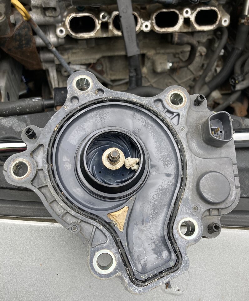

    Sorry to bump this, but I, too, have a 2010 that I suspect has blockages or reduced coolant flow. I pulled the apparently original water pump and found some fairly large chunks (see photo). I replaced the pump and thermostat with Aisin. (Is there really an appreciable difference versus Toyota parts?) There were also some smaller chunks when I drained the system. The car is relatively new to me, so I'm guessing stop leak products at some point. Maybe hard water put into the system.
    I'm wondering exactly where and how I would use a garden hose to flush. Looking through related threads I have a vague understanding of the gen III cooling system, thanks to rjparker and others. Car has 188k. No DTCs. I've driven it 10k. Suspect head gasket, but would like to know the best way to flush regardless.

    Mixing incompatible coolants will also do that. It looks like a chunk of calcium, so hopefully just "hard water". That's why your suppose to only add distilled water to your coolant; if the Toyota or equivalent isn't available.
    Old-timers usually say that it doesn't make a differences (dump anything into the radiator); but these newer cars' tolerances are so tight, not following OEM guidelines can eventually lead to what you've found. Damage is slow and incremental - plus you've already got 180K+ on it.

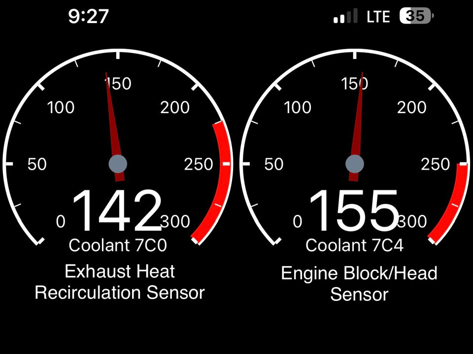

    If a temperature light came on, one of two very reliable sensors reached 248f in an engine that normally runs 195f in summer traffic with 100f ambient and the ac on full blast.
    Assuming no codes (you mentioned none) the first thing I would do is break out my Car Scanner app or Techstream and monitor both sensors.
    If one was hot (215-248f or more) and the other was normal then you have an unusual sensor problem or no coolant at one of the sensors. Most likely both will be too hot after a complete warmup and drive.
