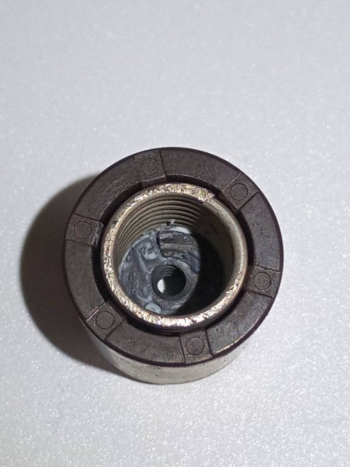

    also forgot to mention i took the egr apart and i moved in and out freely .

    so just to maybe help someone else . problem solved . BAD EGR .the plunger is thtreaded . and can work its self loose . giving all the symptons i described . finger tight . tighten it up and its all good . the hard part is figuring it out . maybe this can spare someone else from the drama . thnx , bill

    As for how the EGR valve is built, the threads in the rotor are how it works. When the rotor spins, the pintle moves inward or outward, because of the threads.
    It's never supposed to be tight. It's kind of hard to even get it tight, unless there is a rut through the ski-jump part.
    If there's a rut it's done for (unless you're one of the creative souls willing to try hot-knife plastic sculpting or the like).

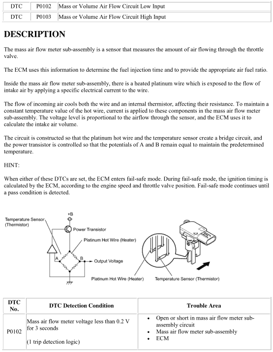

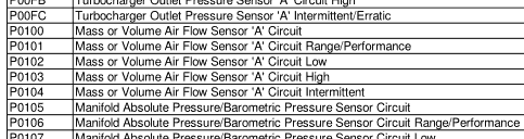

  9. ChapmanF
    28,753
    19,060
    This is what P0102 means in a gen 3 Toyota Prius:
    Here, again, is the meaning of P0102 from a generic, non-Prius list of standard powertrain DTCs:
    The reason it means the same thing in the Prius-specific list and in the generic list is that it's a P0 code, which all are standardized by SAE across the industry. P0102 is not an EGR code in any car anywhere.
    It's hard to tell just where the mistake happened here, whether you or someone else mistranscribed some other code as P0102, or misremembered MAF as EGR, or actually used a buggy scan tool that showed the wrong description. But one of those things happened, or something like them.
    There is a standardized code for an EGR sensor low input, it would be P0405 if a Prius used such a code, but it doesn't.
    Sometimes ya just gota listen, and sometimes ya gota correct obvious mistakes.
