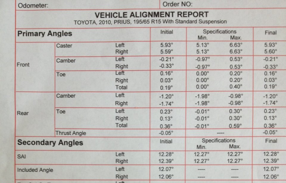

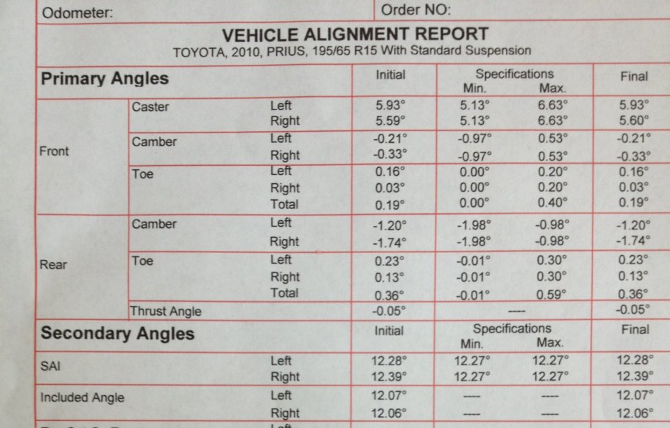

    I had the alignment checked today, looks like all of the settings are in the middle of the min/max range. Any thoughts about these numbers?
  20. The Critic
    The Critic Resident Critic
    Oct 28, 2005
    3,193
    2,333
    CA
    That alignment is just fine - I would not touch it at all. It appears that your steering wheel may be a bit off-center, but that alone should not warrant immediate attention.
