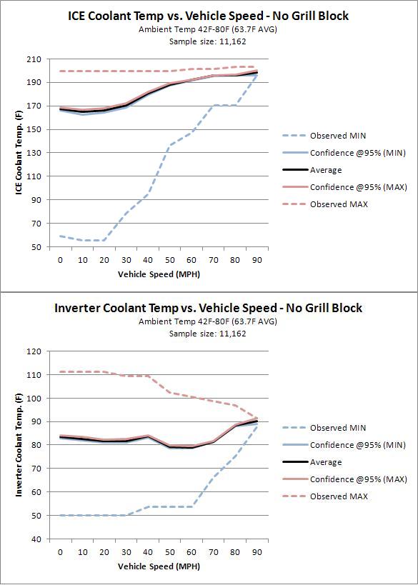

    Pulled together a little bit of data from the past month (September 2012). Gen III no grill blocking. A lot of people have been talking about observed maximum temperatures and so-forth. I've been logging the data in the Torque App for Android, so here's what I've been seeing.
    Vehicle speed rounding in Excel using the equation "=ROUND([mph.xxx],-1)" - which rounds to the nearest 10MPH. Essentially, 20MPH = 20 +/- 5, or 15-25mph. 30MPH = 25-35mph, and so-on.
    ICEInverter by bendertj, on Flickr
    I'll probably start grill blocking this week, so I'll create a new chart later this winter with some of those results.
