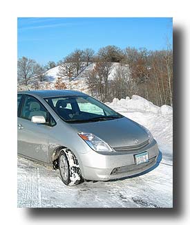

    Here's mine from ages past, same approach for each:
    Note how the front of the car gets dirty, obscuring the look anyway.
    This is with them clean still, basically easy to overlook even then.
    They stay in place all season long, never any effort required after the initial install.
