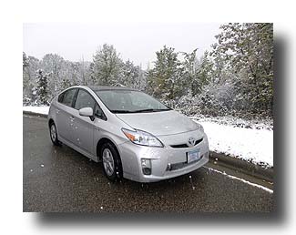

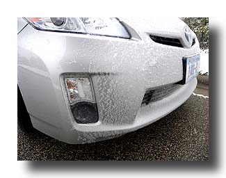

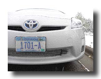

    I blocked 3 slots the other night, mostly since I only had enough foam available for that. It was a good start. But then snow was forecasted! So, I finished by blocking that last slot on the lower-grille. Now, all 4 are blocked. And sure enough, it did indeed snow.
    That meant photos a whole lot sooner than expected...
    [​IMG] . [​IMG]
    Total blocking down below and open on top is the approach I'm sticking with this year. It seems like a good plan and looks surprisingly nice. Larger photos are available on my album.
