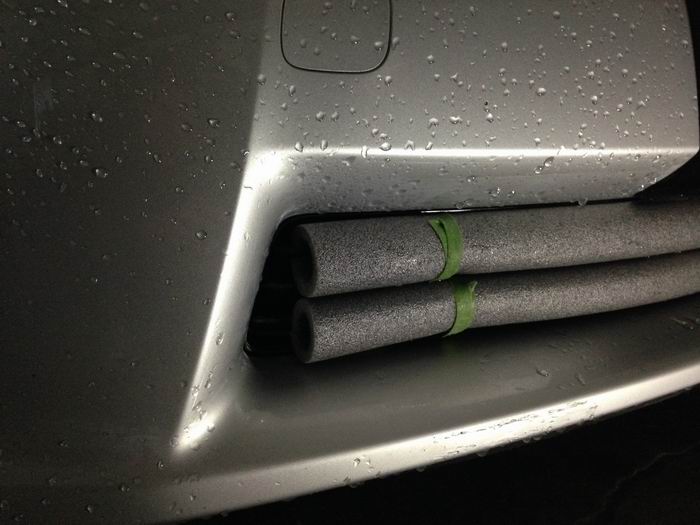

    First attempt at installing tube insulation (for 1/2" pipes) on my 2011 Prius II - I couldn't squeeze a single tube into each opening slot (too tight), and tried using the slit to cover two slots, but it was too loose. Suggestions? I'd like to get this done since winter weather has descended here in Minnesota...

    The stuff I'm using has an outside diameter of 1.5", and the label says 3/4"x3', guess that means it's for 3/4" plumbing pipe. The 3' length is perfect to go full width of lower grill. I secure it with some Velcro tape I got from Lee Valley. I push the tube onto a slat, and it takes a couple to cover the full height of the opening.
    People are using the smaller diameter, think they're pushing it in between slats. The bigger stuff works good for me though.

    That's all I've ever done. Perhaps the problem is the type you purchased, too dense. Try the cheap foam kind for $2.35 from Menards.

    $2.35? That's outrageous! I paid 97ยข (times two) for mine at Home Depot!
