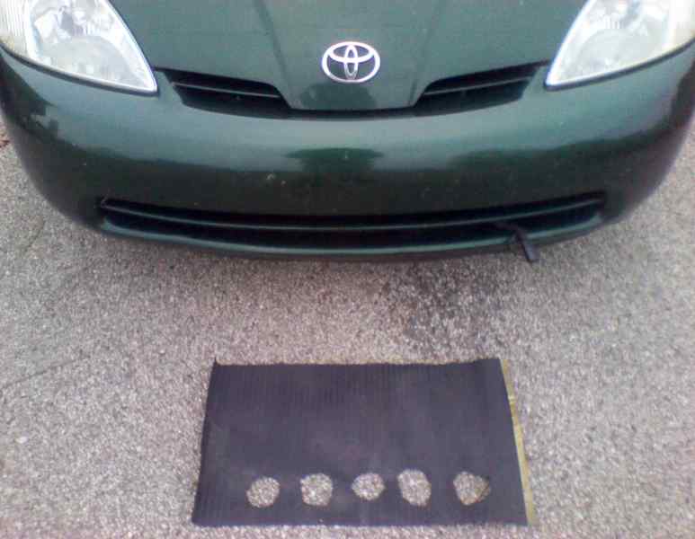

    I use a sheet of vinyl stair tread protector that I just unroll behind the grille. It's less of a fashion statement for passersby; you pretty much can't tell it's there.
    I made it first for my Gen 1, further described in this post, and cut holes in the bottom, because that's where Gen 1's electronics radiator is.
    I just kept it when I got the Gen 3, and put it in the other way, as Gen 3's electronics radiator is on top.
    I've watched the temperatures on a ScanGauge and I probably never even really needed to cut the holes, but I didn't have the ScanGauge at first, and I just didn't want to take chances.
    Sometimes I've forgotten to take it out until quite late in the spring, then I eventually look at the ScanGauge and think "oh yeah, should probably take that out".
