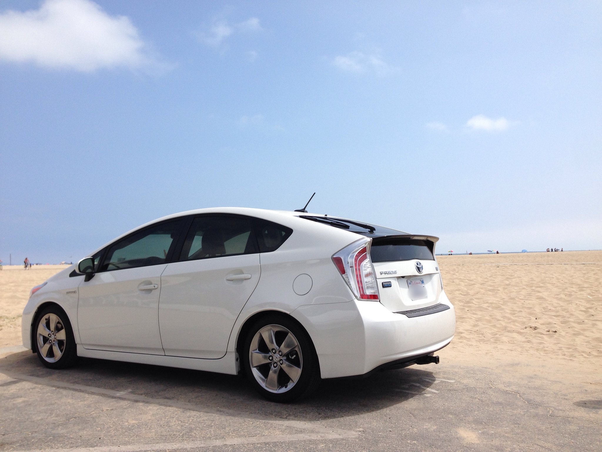

    I have a Curt hitch and no issues with it. Bolts on and I like the round tubing.
    Since the class (1) defines tow and tongue capacities, all bolt on hitch for the Prius are class 1 so same capacities. With the Torklift, you are paying for the aesthetics. I don't notice mind being too noticeable. No matter which hitch you choose, the receiver must protrude. At more than 2x the price, I thought it was an easy decision. You maybe looking at Torklift since it's 2" though. Most if not all the bike rack hitches I've seen are available in 1 1/4".
    In regards to the bike rack, the popular models are "touch less" and just hold the front wheel. Reason for this is a lot of bike no longer have top tubes to clamp on to. I have the Yakima Hold Up and it's worked well.
    [​IMG]Santa Monica Beach
    I also bought my hitch from etrailer.. fast and smooth transaction. Well packaged too.
    The issue I do have is ground clearance BUT that is due to my Plus springs. Either way, you just need to pay attention to how you approach drive ways.
