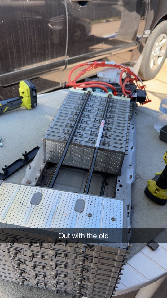

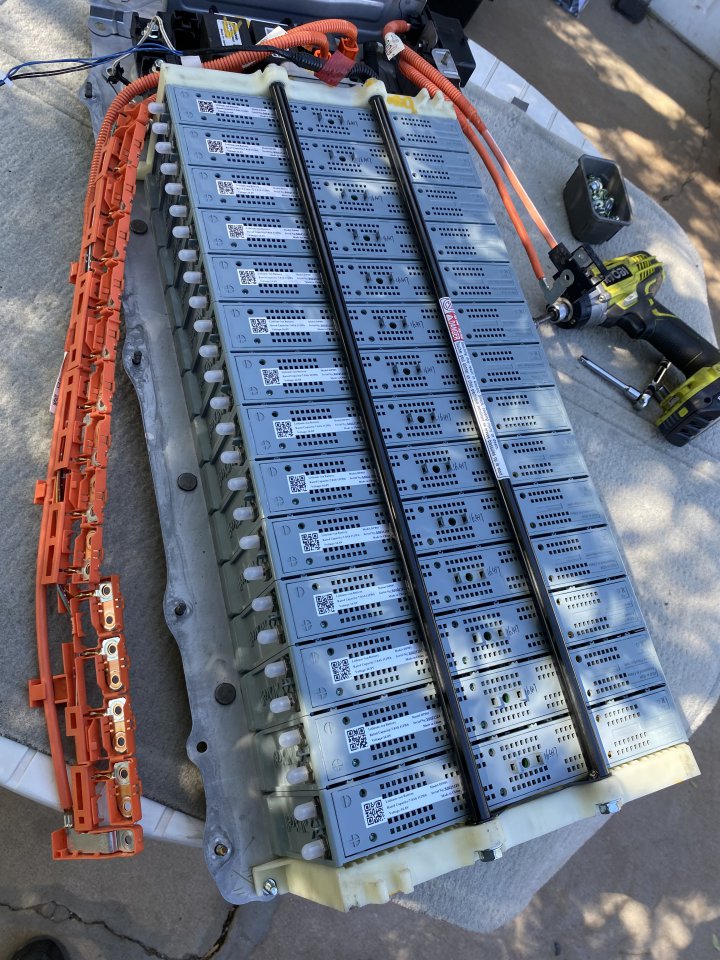

    I bought a 2010 Prius IV about 4-6 months ago, can’t remember the exact time frame. Great condition and it had been with 1 owner. When I first purchased the car, I noticed it was burning oil, the battery was pretty weak, and I was overall not satisfied with it mechanically but was pleased with how great the body condition and Interior conditions were. 3ish months after owning the car, I started getting misfire codes and the engine was shaking horribly. Turns out it was burning oil faster than I could remember to refill, leading eventually to blowing the head gasket.
    I’m not very mechanically inclined but I had removed 3 engines before and replaced them, I didn’t think that was enough experience to dive into a head gasket replacement. The fact the engine was also burning oil meant the rings were seized. I decided to go for a replacement Japanese engine totaling me $1500 out the door. About 12 hours of work later, engine was replaced and runs great. My mpg didn’t go up as I hoped it would but given I live in AZ and the heat is non forgiving, I figured I would tackle the battery next.
    About 2 weeks later I ordered the project lithium battery and installed it. My friend also ordered his and we were able to change both in less than 5 hours. Not hard at all, but did manage to pull a back muscle in between.
    Next on my list are the brakes which I hope I have enough time to do today. I’ll post pictures if I end up doing it. Now I have a 2010 Prius with a Japanese engine with about 40-60k miles and a brand new project lithium battery. I’ll come back to this post to give updates on mpg in the AZ heat.
    I use this car to DoorDash and I am Eventually going to put this car through Uber. My total cost of this car is now running at around $9500. Not so low but I’m very happy with the car.
