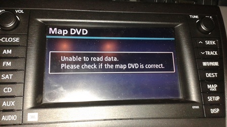

    Hi all, I want to start off by stating that I'm an avid reader and did my best to search for similar issues with 2010/Gen III models before starting a new thread. If one exists related to this topic, please let me know. Thank you.
    A couple of days ago while driving my navigation map went out and a message appeared stating "Unable to read data. Please check if map DVD is correct." I've ejected the disc a few times to clean it with the appropriate cloth, which helps temporarily, but the issue is becoming more common. (The disc says: DVD Navigation Map, North America, U-90, D.)
    Has anyone else had this problem? I have never changed the CD nor had I touched it before this error began taking place.
    Any advice or ideas would be very much appreciated. Thank you!

    Sounds like the DVD reader lens or laser might be dirty or on their way out.

    Friedpez, your problem does sound like a dirty or failing optical drive. If it's not happening all the time I would not take this to the dealer as either you'll be told "can't replicate the problem" or that replacing the drive will probably fix the issue. Maybe a newer unit with disc from the junk yard is a viable alternative.

    My suspicion is that the disc that is stored in your car all the time is degrading and that it is less likely that the lens on the reader in the car is dirty and more that the disc is going. I hope that will help, I'd only stick a cleaning DVD in there as a last resort myself.

    Alright, so it's been about three weeks since I last posted about the issue. Since then, I've noticed that the sounds of the disc being read have stopped altogether. Also, the most common error message now displayed is that there's no disc, asking me to insert a DVD. I think it might be a malfunction of the laser or device that's reading the disc.
    I've tried ejecting the disc, cleaning it with an appropriate cloth, and reinserting it, but it's to no avail. Unfortunately (or fortunately) I'll be out of the country for the first three weeks of September but I think I'll get it checked out once I return.

    A while back I burned a nav DVD on my computer & it worked fine in the Prius.
    While traveling, at a location ~300 miles away, I started getting the "unable to read data" (iirc) message at times.
    It seems the nav unit would retry & eventually get the data needed but the message would still pop up at times.
    When I got back to my home area the nav unit performed flawlessly.
    The fix to my problem was to burn the DVD on another computer.
    This new DVD has been in operation for ~6 months with no problems anywhere that I currently travel to.
    So it is possible for the DVD to be the cause of these problems.
    But note - my DVD was one I created (or burned), not an OEM DVD which is pressed & is _much_ better quality.
    Maybe you could find another 2010 Prius owner with nav & swap DVDs & see if your disk will work on a known good nav unit?
    I think 2010 & 2011 both use the same GEN6 DVD - not positive.

    I also have a 2010 Prius and have started having the exact same DVD error with my NAV system. I had assumed the problem was with the DVD reader and not the DVD itself, but I saw people on here were proposing it could just be the DVD. Could someone who's had this problem please post an update? Did it solve the problem long term to just make a copy of the failing DVD on your computer? Or did you end up having to swap/replace some hardware?

  20. Brian parquette
    Brian parquette Junior Member
    Aug 21, 2021
    Santa cruz ca
    Problem is maps dvd player loads all the software for the whole sound system(stupid) . So dvd player is garbage and has to be replaced. Its broken. And dust in car gets in and or mechanism is busted. You have to replace it inside console. It can be fixed at audio shop. They are familiar with the problem.
