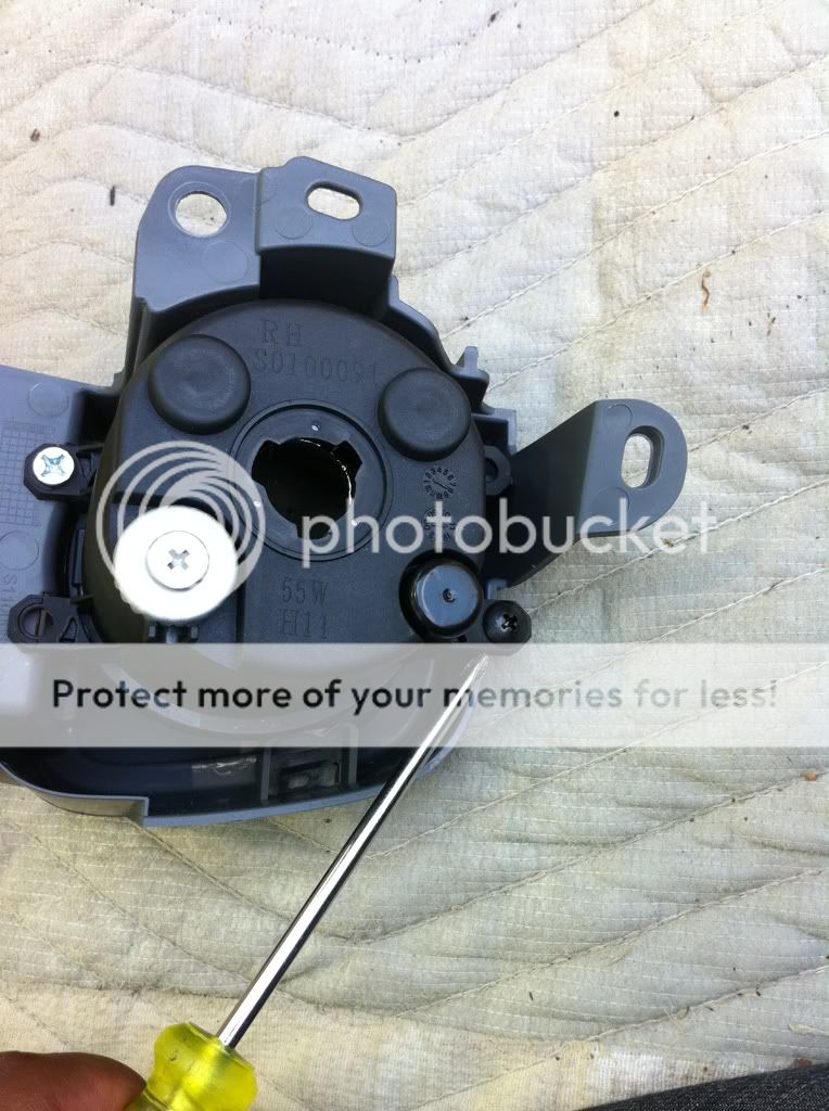

    Did my install yesterday. Took about 4 hours including installing HID's in the fogs. Spent about an hour between troubleshooting where the fail was and having the having the connection plug from pulling the wire through the firewall come off. The red tap that came with it was a little too big and didn't penetrate through the wire insulation to make contact with wire inside. I used the light brown wire but you can prob use any wire that supplies power. I also added another screw to secure the fog light to the plastic housing. The black screw is where it's drilled for the factory screw to go. The silver screw I added for more support cause the fog light moved around too much with just the 1 factory screw.
  12. kc5tvd
    kc5tvd New Member
    Apr 23, 2011
    LaPlace, Louisiana
    The two tabs on the light go into the two slots in the plastic housing. My lights didn't move at all with just one screw.

  14. kc5tvd
    kc5tvd New Member
    Apr 23, 2011
    LaPlace, Louisiana
    It happens, at least it should be a easy fix, the hard part is already done.:)
    I think my lights are aimed a little higher that i want them, i searched and found a post with a picture that showed a vertical adjustment screw on the light itself. The light in the picture was not the same as the light in my OEM-Quality kit, almost but not the same. I wish i would have looked into this before i installed so i would know how and if they can be adjusted. I guess i will be under the car again soon also.
    I will do more searching, but if anyone knows how they can be adjusted i would like the info, Thanks.
  15. spiderman
    spiderman wretched
    Jul 5, 2009
    7,543
    1,558
    Alaska
    That silver screw/cog as shown above is the adjustment. The other ones just have that additional plastic cover of the adjuster. Follow the fog light link in my signature for adjustment details.
  16. kc5tvd
    kc5tvd New Member
    Apr 23, 2011
    LaPlace, Louisiana
    I was hoping that would be it, thanks for the quick reply, and info.

  18. Silver NY P3
    Silver NY P3 Junior Member
    Apr 23, 2011
    45
    St Louis, MO
    Yeah the silver screw. There's even a cut out in the plastic guard under he car for you to reach the adjuster screw. Just on the bottom side there's a groove that the philips screw driver slides into and it turns the silver adjuster screw like a gear to adjust. Cool design!!!
