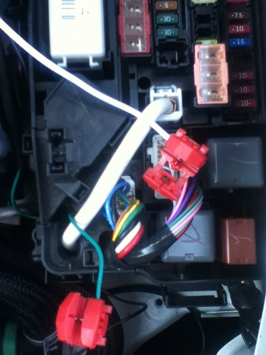

    Hey guys,
    I'm installing fog lights I got from Rakuten.com and ran into a little hitch. The only thing through the firewall was the switch so I have 2 wires to connect in fuse box and I'm not sure how to do it. The white wire is the power going to the lamps, can I buy a connector and plug it right into the fuse box like the wiring that comes with the PC set? Other ideas? This would go into the slot right above the white wire already plugged into the fuse box.
    The 2nd wire is green, this is the ignition/on switch. Can I tap it into the brown wire in the bundle going into the fuse box? Is this the same brown wire below the dash?
    Thanks for any help and insights.

    kawita, yes you can put a connector on the white wire and plug it in to one of the empty terminals in the fuse box. However, I'm not sure whether the green wire should be connected to the brown wire in the fuse box that you mentioned. You have run two wires into the car for the switch, so why not run one more and tap into the brown wire behind the dash as outlined in the instructions for the OEM foglights?

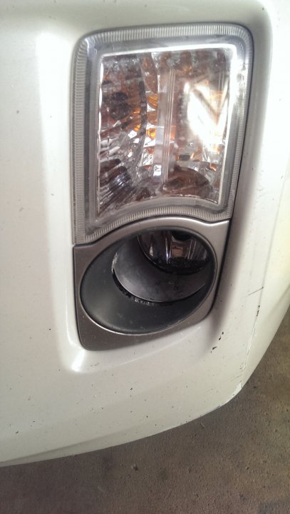

    Is there any way to buy just the drivers side lens/bulb?
    I have a 2010 Prius 5, however, the drivers side fog is cracked. Toyota wants $160 so even the full kit is cheaper than that, but I figured I'd see if I could just get one. Also is there any way to order today and get it to 60101 by Sat?
    I'm in Chicago now and need it for the ride back to AZ. We leave on Sun.

  17. vr4playa
    vr4playa Junior Member
    Oct 4, 2013
    Phoenix, Arizona
    Unfortunately it's more than a hairline. Here's a pic...
  18. xliderider
    xliderider Senior Member
    Apr 19, 2012
    8,140
    3,274
    Honolulu, HI
    Yikes, looks like you lost both the lens and bulb. :eek:
    The bulbs are easily replaced, they are H11 55w halogen bulbs.
    If you have access to a dremel type rotary tool with a cutoff wheel and a sanding disk, this is what I would do. Buy a small sheet of Lexan or acrylic from a local hardware store like Lowes's or Home Depot (1/8" or 1/4" thickness, 1/8' will definitely be easier to work with). Lexan will probably stand up to the heat from the halogen bulb better than acrylic, but both might get hazy after a bit from exposure to the heat. Remove and clean up all the broken lens pieces off the foglight housing and any adhesive from the housing. Place the foglight onto the sheet of lexan and trace the housing outline with a felt tip pen, it's going to be an oval shape. Cut the lexan with the rotary tool and finish off any rough edges with some sanding. Glue the temporary lens onto the housing with some silicone adhesive, preferably some high temp gasket type and set aside to cure.
    That should be adequate to get you back to Arizona. The lens doesn't focus the light, it's just there to protect the bulb. Then you can take some time to get a replacement foglight once you're back in Arizona.
