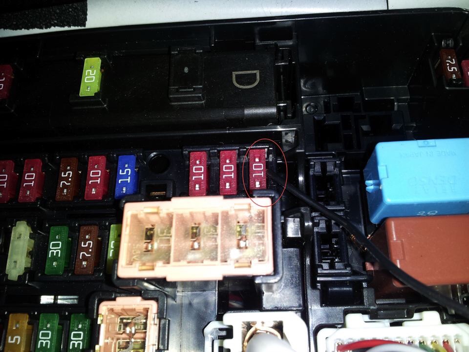

    Hello guys. I had to dig in to an old topic not even completely relevant to my question but...
    I have installed Osram LedFog lights to my 2011 Prius and the fog part was easy. Lamps installed easy and even the wiring was very simple (they use original connectors). Anyway, the DRL part is more complicated. They require continuous voltage (which, I presume, should be easy to take from the fuse box according to the wiring instructions in the first post) and voltage when the car is "running". Can I use the mentioned brown wire in the ECU to do this job or is there any place in the fusebox where I can get 12V ONLY when the car is running?
  11. sfv41901
    sfv41901 Masta S
    May 5, 2010
    4,591
    5,293
    Palmdale, Ca
    Use this fuse to power ur DRLs. It's constant +12v when in ready mode
    Using this will make it easier
    iPhone ?
    FinToy likes this.
  12. xliderider
    xliderider Senior Member
    Apr 19, 2012
    8,140
    3,276
    Honolulu, HI
    FinToy, depending on how many amps your foglights pull, you might want to consider using a relay. Draw power from the constant 12v terminals at the back of the fuse box like in the foglight installation instructions, but use the fuse tap and fuse sfv41901 indicated above to trigger the relay coil.
    FinToy likes this.

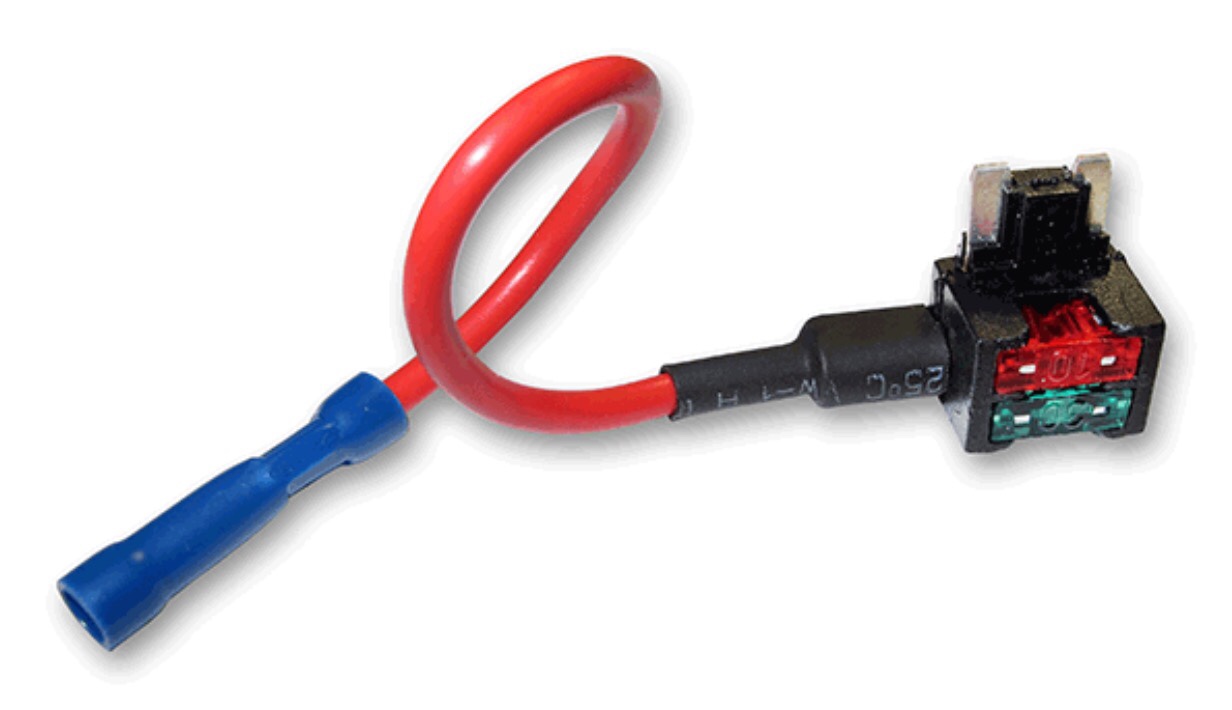

    BTW,
    Where can I get ones? I have never seen those before but they seem handy. Thanks again!
  14. xliderider
    Apr 19, 2012
    8,140
    3,276
    Honolulu, HI
    Search for low profile mini atm add a circuit fuse tap on eBay
    FinToy likes this.
