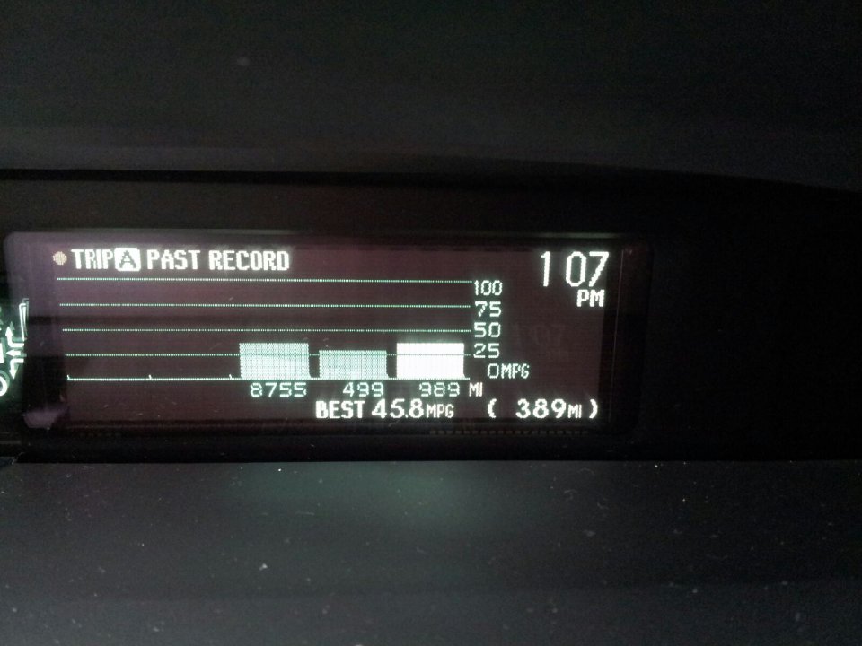

    This was my first time actually calculating the mileage, but as I mentioned in another post I am familiar with my mom's 2010 Prius and mine has been getting bad mileage the whole time I've had it, driving under varying conditions. I have not reset the fuel meter. Here's a screenshot of my mpg display, not sure how this compares...

    I agree that storing your bicycle inside the car doesn't add any significant weight to kill y our MPG.
    I'd focus on looking at your tires, and driving habits. I like to keep my eye on the MPG meter that's to the right of the speedo on how heavy I'm pressing down on the gas pedal. I focus on trying to keep that as close to 50 or higher as possible.
    I'm assuming that you've checked your tire pressure and at a minimum, they are at 32psi?

    I would focus on your driving habits a bit more before spending more money on analysis, tires, and whatnot. I have had my 2010 for 2.5 yrs and my MPG can vary from 32-49 and it is all about how I drive the car.
    I have aftermarket tires (not as big as yours). When I am only driving to the train station and back (typically 2 mile super race bc I am always running late, stop and go for traffic and lights) well that is when I get 32.
    On other occasions, my daily commute was 45 miles each way, a lot of freeways, almost no stopping my average was >48 and climbing. The more you drive the car and pay attention to what is happening, the easier it will become to get to those higher numbers.
    That said, remember to drive safely as opposed to hypermiling. The $3 per tank savings when "Driving Mrs Daisy" is not worth getting into an accident or being the Prius that caused it.

    Get a working pressure gauge and try tire pressures closer to 36 or above. I run 40 psi but it's a little harsh, even with the 15".

    Were the tires morning cold, or had they be run long enough to warm up? If the former, you can do better with more pressure, but it will come at the cost of ride harshness. If the latter, then your tires are definitely underinflated. Check them again first thing in the morning, while they are still cold.
