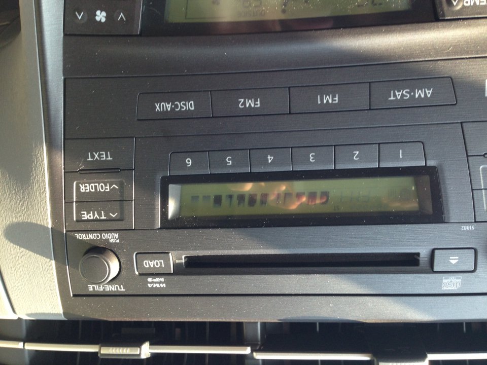

    I have a 2010 Prius (model III) that has begun doing this thing (just one month after the 3-year warranty expired) where the radio shows garbled stuff when the Prius starts up. It also starts automatically ejecting the CD. Pressing the buttons doesn't help. To fix the problem, you need to restart the Prius.
    This only happens once in a while, but it is starting to happen more frequently.
    Does anyone else have this problem? A picture is attached showing this problem.

    Try running a cleaning disc through it and see if that helps. I assume this only happens when a disc is in the drive?

    Thanks for your feedback. I set up an appointment tomorrow with the dealership. I think the discussion will mostly revolve around the photo and video.
    If they won't repair it under warranty, I'll see if it happens again if no discs are ever stored inside. I think there is a circuity problem inside the audio system.

    I was charged $67 from the dealer just to look at the car.
    They are saying I need a new radio that will cost $450.
    This is terrible. I'm most likely never buying a Toyota again after this experience.

    How about answering the question:
    Does this only happen when a CD is in the drive? If so, try the cleaning disc option. You could be looking at an error with reading the disc, was my point. Recordable discs are well known for giving fits to players. If it happens with no disc in the drive, then yes you might need a new unit.

    As the car is 3, check the 12v battery, weirder things have been know to happen when the 12v is low on umph and 3 years is about it's tour of duty;)
    If you truly do need a new head unit, crutchfield isn't a bad place to start

    Great advice, thanks a lot! I don't believe the problem is from how the system is reading CD's. Nonetheless, I'll leave the CD's out of the unit for a few weeks to see if it happens again.
    I like the idea about looking for a second hand unit from a wreckers.

    Unfortunately the same thing happens to me minus the CD ejection, right when it was 3 months out of warranty. The radio works fine but the display is either blank or garbled from time to time. Seems to be worse in extreme temperatures above 80 degrees with high humidity. When it's garbled I turn it off then on, seems to help fix it. When it's blank I lightly tap the upper right hand corner of the radio and it lights up normal. I'll just live with it till it dies then replace it with a used one or after market.

    Thanks for commenting, Fore! Even without any CDs inside, it still fails as shown in my video. I also think it has something to do with heat and/or humidity.
    At least we got a car wash when it was reviewed by the dealer for $67! Haha!

    I had this happen with mine before as shown in the video below. It eventually worked itself out and hasn't occurred again. It's been almost 2 years and hasn't had any issues.

    I have to same thing happening to my 2010. I live in Mass so I first stated noticing it in the Cold weather, not Hot. My remedy is to turn the defrosters on and that seems to warm it up in about 10 minutes and it works again. I can use the Steering wheel controls to listen to the radio because all the radio buttons just seem to turn the unit on and off. I'm skeptical about the battery voltage suggestion but will put a voltmeter on it and keep and eye on it.
