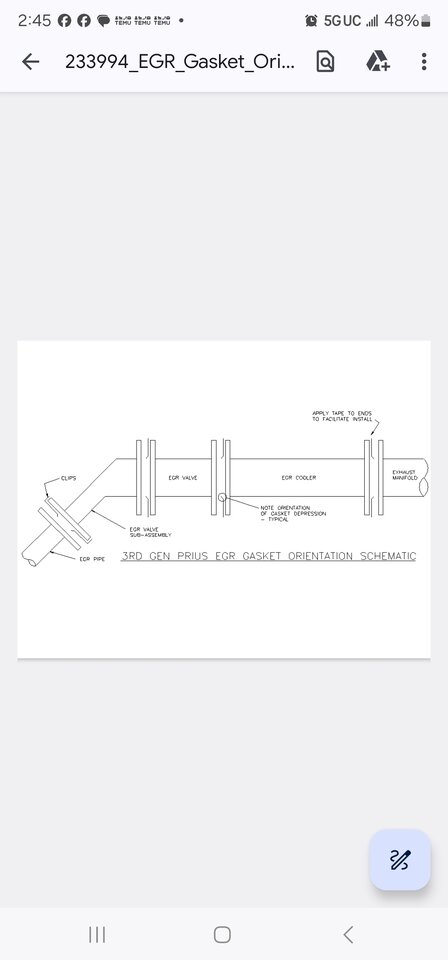

    I would look for a bad or missing gasket either where you are blocking egr flow or on the valve or cooler.
    There is also a specific direction for some of those gaskets.

    All gaskets are new, fitted properly, and there's none missing.

    Then you have a hole in the cooler, pipes or valve. It makes better sense one of the gaskets are the problem or a bolt is loose if your flow blocking is solving the issue.
    When you have checked everything and the problem remains, one of the assumptions is false.

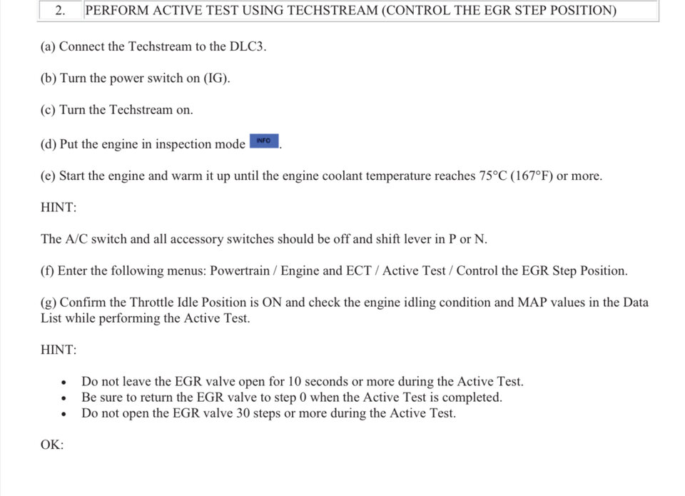

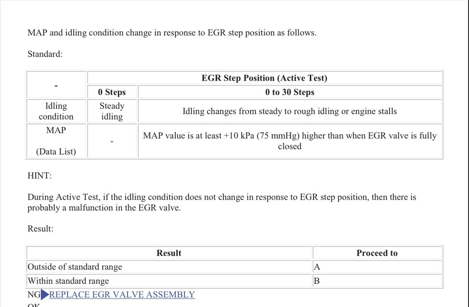

    Another test is the egr step test while monitoring map pressure with Techstream. It forces the egr open and close while in maintenance/inspection mode.

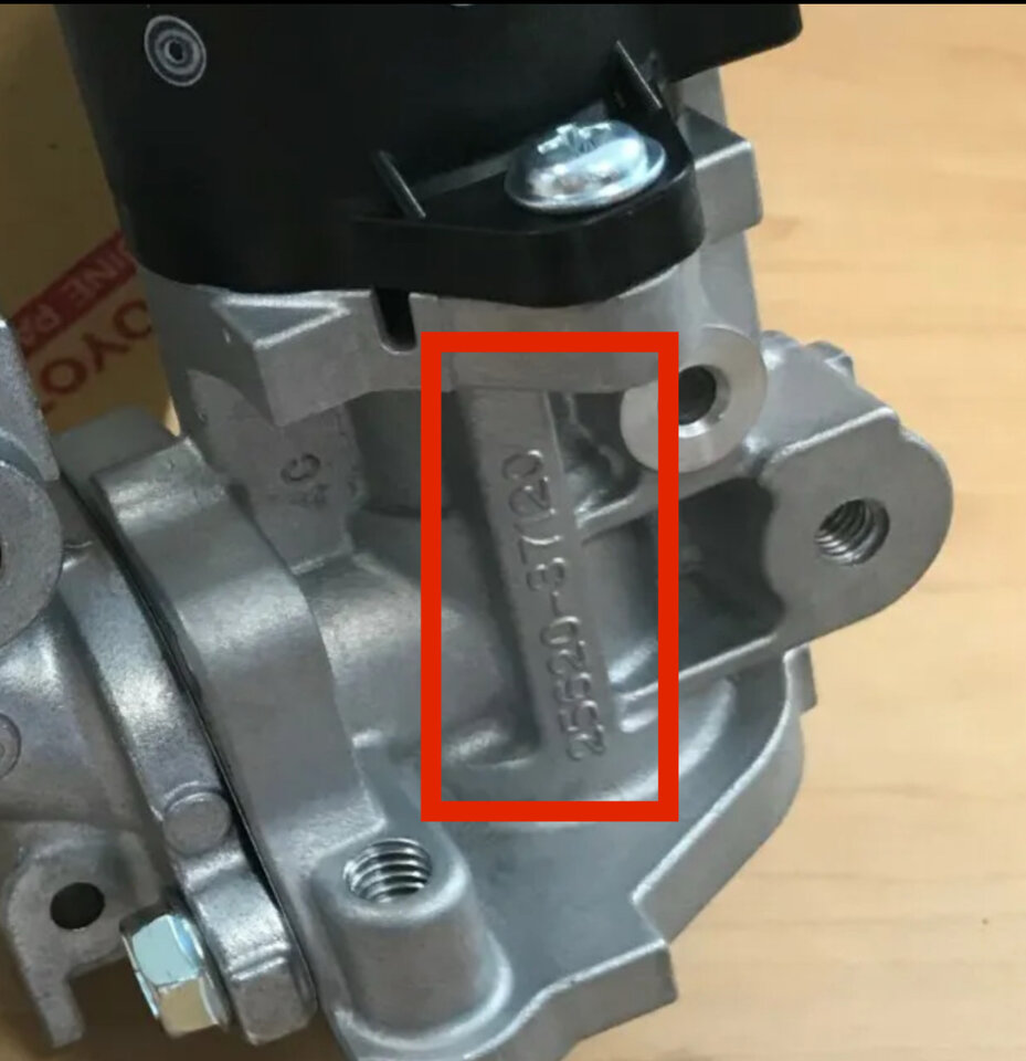

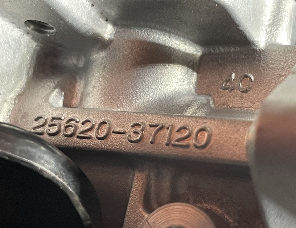

    Does the new egr have this number embossed in it?

    Yes, my new EGR has the same number

    Hmmm, I'll triple check again if it's the gaskets, but I swear they're on right and not blocking. There certainly isn't a hole anywhere and I torque all the nuts to spec. Will check gaskets in the morning b/c I don't have the energy to clamp the hoses and pull that EGR out again
    Will look into egr step test too
