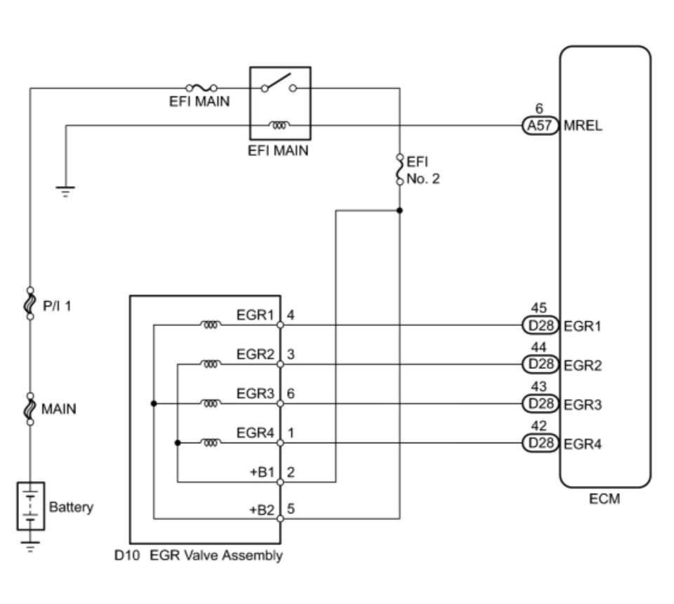

  9. ChapmanF
    27,591
    18,187
    The valve just has a six-terminal stepper motor. The ECM just sends pulses to the windings in the right sequence to step it one direction or the other. You can watch the pulses on an oscilloscope.
    ECM sending the wrong pulses to the valve isn't a problem I've heard anything about.
