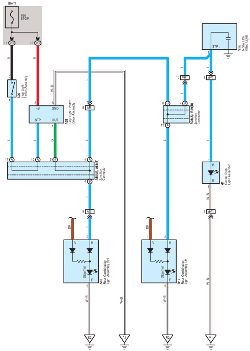

    Back in July , I had a weird issue with my car that won't go into drive cause of a blown STOP fuse (by the pedal fuse compartment) .
    It happened again yesterday . The 10A Fuse blows as soon as I press the brake pedal! I wasted like 5 different ones. I also changed the brake light switch and put the old one back to see if it was that but no fuse keeps blowing!
    I didn't do any modification on the car at any time.
    What can it be ? WhatsApp Image 2024-12-21 at 17.39.15.jpeg WhatsApp Image 2024-12-21 at 17.39.15.jpeg
    Thanks and Happy Holidays!

    Downstream of the STOP fuse are both the stop light switch and the stop light "relay". If a newly replaced fuse doesn't blow until you press the brake, there's either a problem in the short length of wiring from the switch to the "relay", or a problem in the relay or the circuits downstream of it.
    This diagram only shows the downstream brake light circuits. Toyota's diagrams are like that. That junction connector A50/A51 also has a beige wire leaving from A51 pin 3 carrying the OUT signal to the skid control ECU so it knows when the stop lights are on. That's shown in a different diagram ("ABS, VSC, TRAC") but should be included in your testing also.

    @ChapmanF NICE(y)
    Buy more fuses:p, you've got a dead short somewhere. If the car has ever been in a fender-bender, I'd start inspecting the wiring harness there. Look for any exposed wires (no insulation). Also check for rodent chew marks too. I've seen shorts in lamp sockets too, usually caused by water leaking into the brake lamp assembly.
    If you can't find anything, pull those left/right brake lamp relays and test again. If the fuse doesn't blow, issue is downstream of those relays, if it blows, problem is between relay and brake switch. From there, isolate right or left side that's shorting. Install one of the relay and test again. If you pop the fuse, there's a short on that side of the wiring going back to that lamp. Lastly test the other side by moving the relay to the other side or use the other rely to test the relay itself and test the other pathway.
    Hope this helps....
    Note: looks like that left relay also lights up that middle rear brake lamp, someplace else to check - if the short is on the left relay circuit. Please double check, my eyeballs aren't as sharp as they used to be.:(

    Thank you so much! Is there a way to get a better quality picture of the diagram? I can't see what's written. thanks

    It might get a bit bigger (depending on the browser you're using) if you right-click or long-touch it, "open in new tab", and view it there. Sometimes a second click or touch brings it to 1:1 scale.
    You can always get it from the source, too: Toyota Service Information and Where To Find It | PriusChat

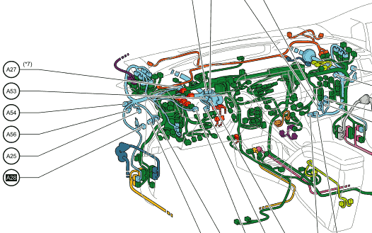

    The stop light "relay" (there is only one, A28 in that diagram) has a black 10-pin connector you just unplug and plug onto the new one. I keep putting it in quotes because it's not a plain relay, it's more electronicky than that, and might be a little pricey. I would look for a problem elsewhere before assuming the relay is the issue.
    If you do decide to replace it, it shouldn't be hard in theory, but in practice I've never checked how easy it is to get to. Looks here like it might not be too bad, kind of up on the left kick panel, maybe near the parking brake pedal.
    For those diagnostic jobs that start with "buy more fuses", one option is to use something like a Fuse Buddy. You take the fuse out, put it in the Fuse Buddy, then put the Fuse Buddy where the fuse went. The leads from the Fuse Buddy you can run to a meter, or even just a 12V light bulb or buzzer. When you make the fault happen, you just get a light or a buzz (or a voltmeter reading), and don't blow the fuse.
    A fuse can blow either because of an overload (somewhat above the fuse rating over a period of time) or a short (some usually intermittent issue where some bared wire can touch a ground and conduct very high current, blowing the fuse very quickly). Sometimes you can tell by looking at the fuse whether it melted peacefully, or splattered its insides with molten metal.
    Yours look pretty splattered.

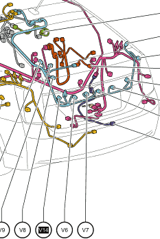

    The noise filter mentioned upthread seems to be placed a little differently in the diagram I attached and the one rj attached. Notice in the one I posted, it is V14 and located between the VR1 and dV1 connectors. In rj's diagram, it's R32 and located upstream of VR1 (also seems to have changed to a combined noise filter for the center stop light and rear defogger). I'm not sure how to account for that; the diagram I posted is from the 2010 US Prius liftback diagram, but I don't know what exact diagram rj posted.
    According to the diagrams where it's V14, anyway, looks like you'd find it by popping off the inside hatch trim.
