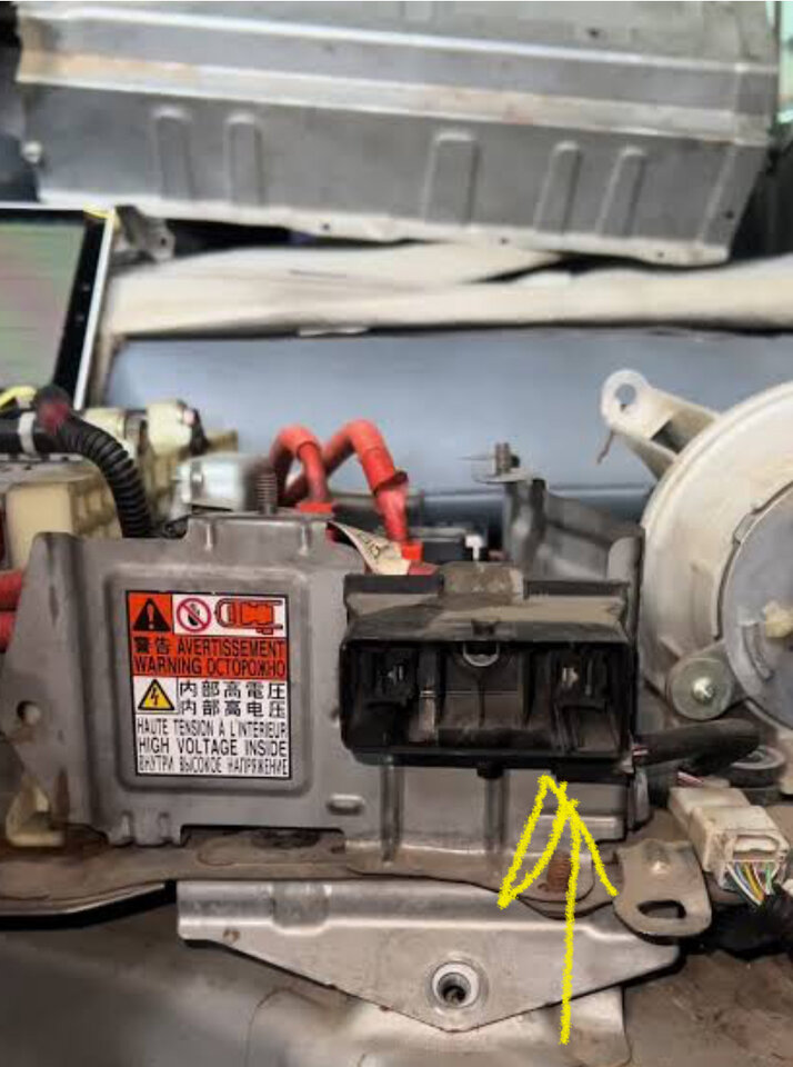

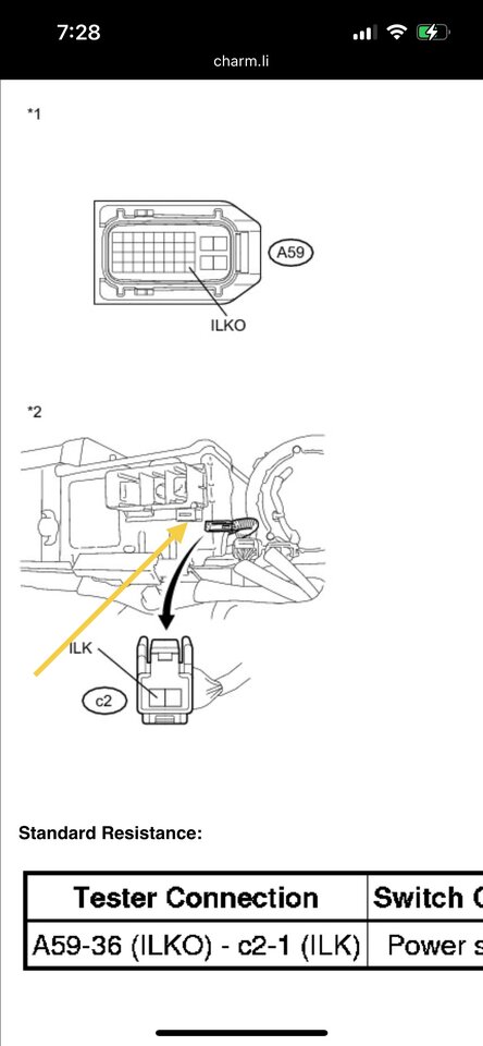

    Literally, bought it disassembled and in pieces. A few weeks of charging all cells, and got it running finally with traction lights,abs, red triangle;unsure if traction pack is working entirely. And have more test to run in Dr. Prius- all lights went away after a drive and obd II reset except P0A0D.
    Initially had codes P03BD,U029A; cleared these and drove it more and now triggered P0A0D. Reset it again.
    Checked the “Main safety battery Interlock Disconnect” and the lever was engaged to the right as others suggested this would trigger that specific code. Watched a video of removal, and noticed under the disconnect there is a 2 pin wire below the interlock. It’s also connected.
    Any other ideas to check in case it reappears?
