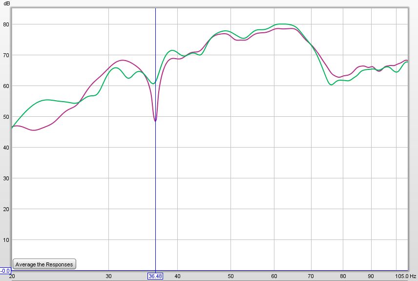

    I added a LoPro SSL 10-inch powered low-profile subwoofer (Same as BOSS BASS1200) under the passenger seat of my 2010 JBL Prius. I had some observations I wanted to share in case someone else was considering the same. My goal was to create much deeper bass, not more volume, which means add power in the 30-60Hz range. The JBL actually sounds pretty good alone, but lacks true depth. The LoPRo fits easily longwise under the passenger seat, or very tightly sideways in which case it is hard to remove. In either configuration you can get to the controls to adjust it. The satellite radio receiver will need to be moved to make room, but this is not difficult and only involves removing two bolts and a few screws. Installation is pretty straight forward especially using the information already provided in this thread, so I won't discuss it.

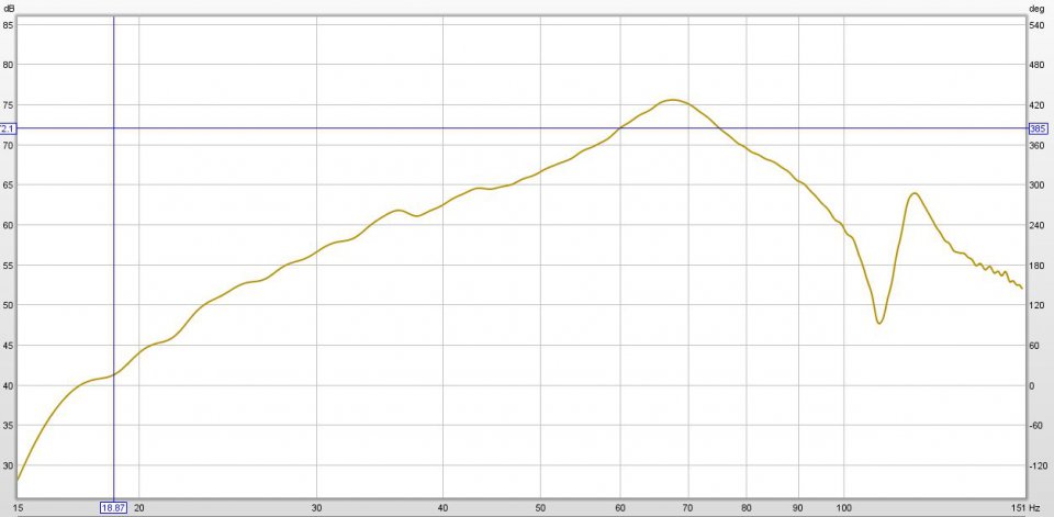

    Adjustment: I used analysis software and a profiled microphone to assist configuration. What I discovered is that the sub's variable crossover is not too great, it is probably a first or second order 6 or 12db/octave crossover, with total lack of precision where the crossover point occurs. Since the sub has significantly higher output at 70Hv, even crossing it at 50 Hz leaves a lot of output at 70 Hz, where the JBL Prius already has sufficient bass. See attached chart of the sub's native output when crossed at 50hz, notice the funkiness around 120 Hz which although odd does not sound bad. I found the best settings were setting the crossover point to the minimum of 50Hz, and setting the subsonic filter to it's minimum of 20hz. Because the Prius uses 2-ohm speakers, I found setting the input gain very high, and the Bass gain very low was best. Be advised on my remote volume control, all the changes take place in the first 10% of knob twist, the rest of the dial makes no difference. Basically the LoPro SSL has good apparent build quality and lots of features, but the features are not too well implemented.
    Measurements: Once driven via the rear door woofer output of the JBL (should I have used the front door woofer instead?), the output falls off quickly below 45 Hz, see graph. The Prius interior has a sharp null at 36.5Hz, which incidentally goes away when the windows are cracked even an inch open. Opening the sunroof made no measurable difference. In the second graph, the purple line is JBL plus subwoofer with windows closed, and the green is with the windows cracked. Moving the subwoofer under the seat which is where it was for these measurements (versus in the passenger foot area) has the effect of smoothing the peak at 70 Hz, and sounds best to me.
    Conclusion: The 10-inch powered under-seat subwoofer definitely increases bass power and adds more depth, but it is not the end-all in solutions. I think it has plenty power, but would need better controls and a non-filtered audio source to sound best, I may some day add my own crossover for best control. In the meantime, there are no drawbacks to the sub, the music definitely sounds better, and the graphs reflect a more level bass response (sorry I forgot to save the "JBL only" graph, but it was much worse).

    Image: Native response of the sub, crossed at 50Hz
    Image: JBL+Subwoofer after adjustment and under drivers seat. Green line is with windows opened one inch. Microphone located near driver's head area. Purple line is "normal operation" with windows closed.
