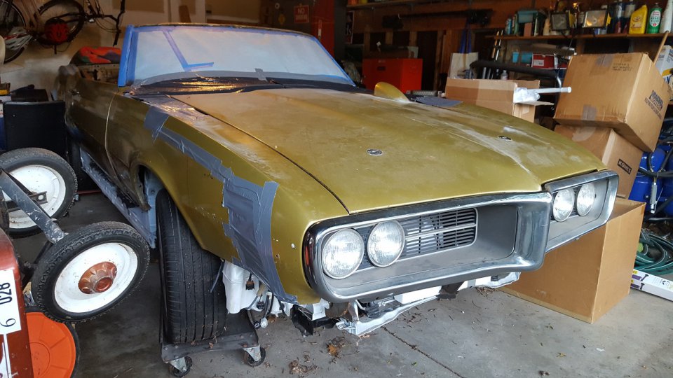

    Perhaps they are available at some surplus stores. There was a time I had access to lots of many different amps; but it would take rewriting an entire 1968 firebird.
    In retrospect, they were easier then and we had lots of space to work with.
