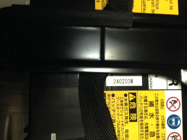

    Ours has smallish white sticker saying "240210W". So, the same as yours except for the underlined portion. The battery was installed at time of purchase, November, 2010. Puzzling, maybe by design?

    I think I can see the reason for Yuasa's obscure coding method: they don't want people to be able to readily read the date code, cherrypick from batteries in stock. Reading a bit here, several people contacted Yuasa with a code, and they responded, told them the date, but there doesn't seem to be a readily apparent correlation. Shades of "The Imitation Game"...
    Yuasa date of manufacture?
