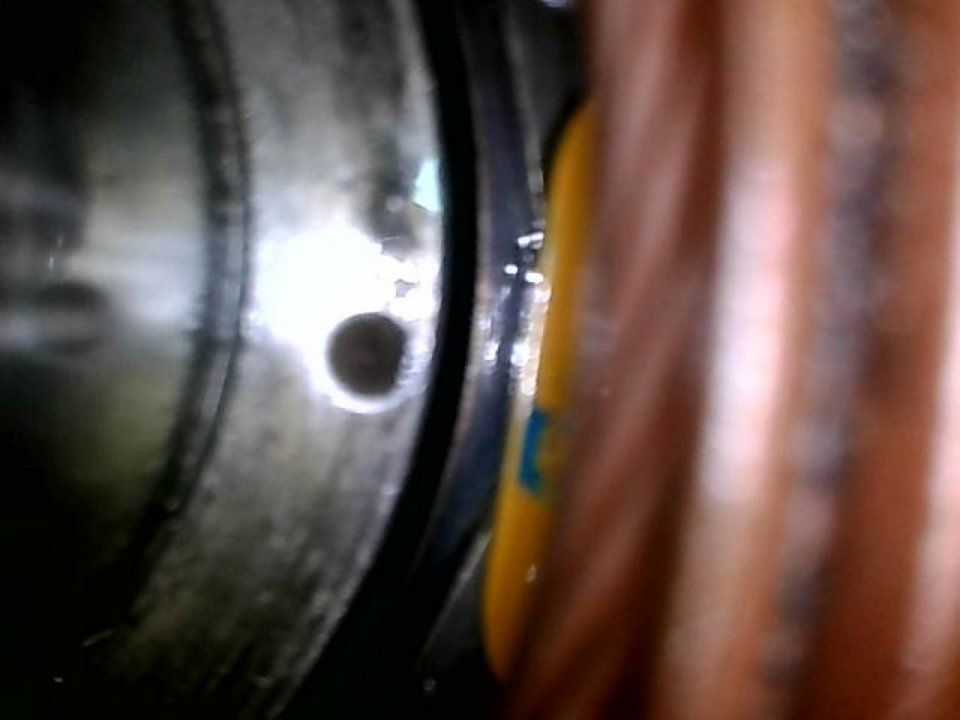

    Somewhere somebody posted a photo showing how, with the crank pulley removed, if you squint just right between the shaft and the oil seal, you can spot when the painted link is at the dot.
    Just where was that? Search search search. Dig dig. Ah yes, johnnychimpo in 2021:
