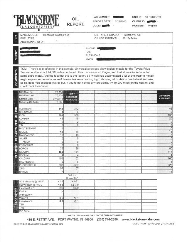

    Fluid came out a dark brown. It didnt look too bad for having 70k. I was expecting worse. Sent sample to Blackstone Labs. Should hear back in a couple of weeks.

    Sure. When it gets sent I will post it. It is my first tran fluid change so there is no history other than what they have as an average for this fluid.

    Transaxle Fluid Change Analysis - I am glad I changed the fluid. Wish I had done it at 30k.

    WOW! What insane levels of Aluminum! Lifetime oil NOT! Thank God I changed MINE! Whew!

    I cant think of any wear parts that are aluminum. So that must be from the manufacturing process. Imagine all that metal being sloshed around by those motor armatures and pumped through the bearings. I think I would not go more than 20k on a new Prius without changing the transaxle fluid.
    Im going to change it again in another 10k to see what comes out.
