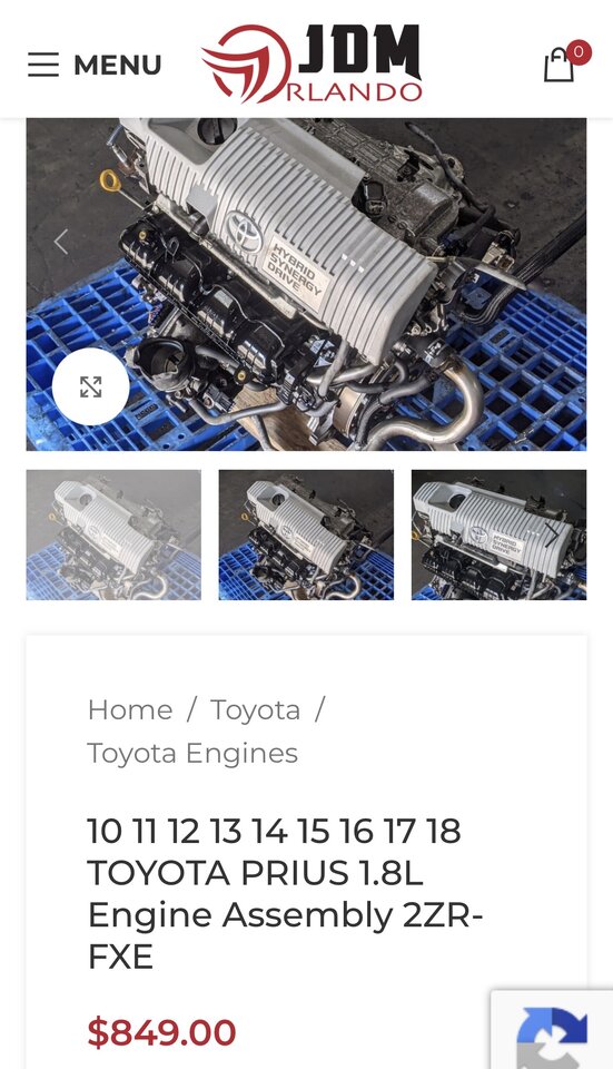

    The problem is the used car market is ridiculously high for a decent 100k mile car and still high for a 200k car. I would check your options.
    The value of your car with an advanced head gasket (rattling at traffic lights and white smoke) is from zero as a trade in to $1500 on the person to person market.
    Unfortunately the right repair at this point might be a replacement engine. If the car is otherwise in good condition I would consider a JDM engine (used in Japan engine imported by JDM distributors in many big cities). Typically $1k plus installation at a local shop.
