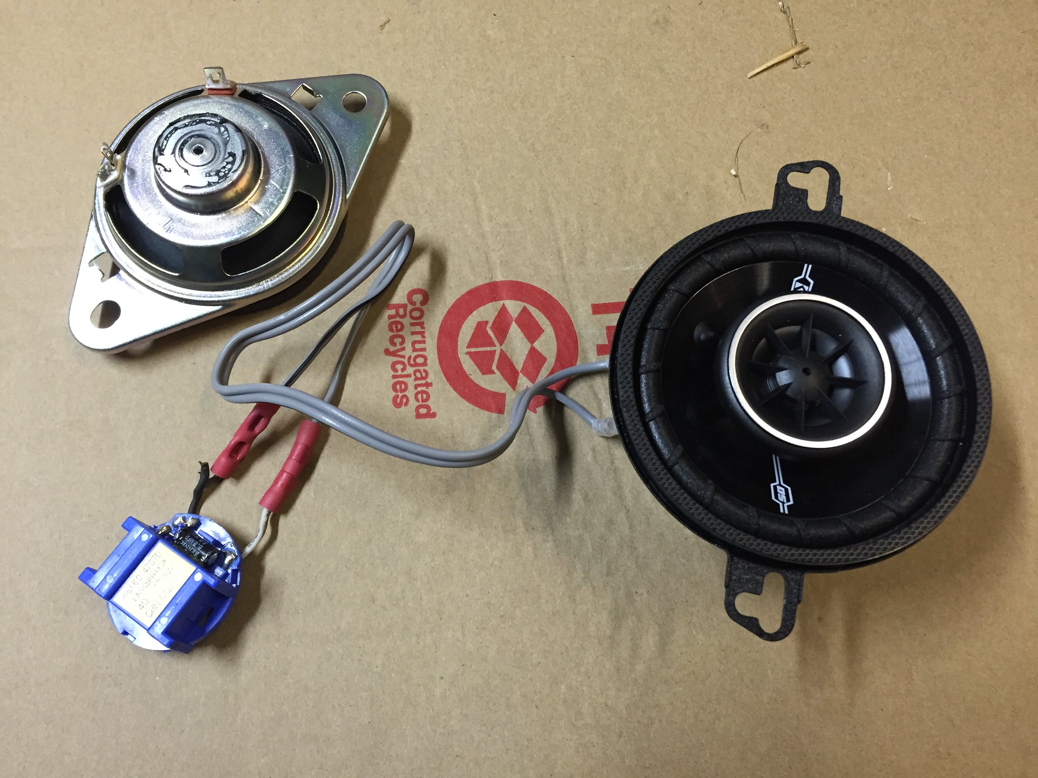

    I just finished replacing my dash speakers last night in my Persona. So I have the Navi non-JBL system. What I was surprised to find was the connector behind the speakers that used to connect the door speaker in parallel. I just used it to connect to the new speakers and not have to fabricate a jumper. Also, the white wire is + and black is negative. I did have to trim dash slighty but not too much. These are Kicker's 3.5" speakers(Kicker 41DSC354).
    Works great and sound isn't even comparable as the squawkers could not even hit those upper frequencies. It did pull the sound stage slightly forward as they are much brighter. I plan to replace the door speakers next so that should pull it back.
    Hope these photos are helpful.
