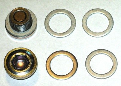

    Drain and fill bolts are the same, torque 29 ft/lb. You need a 10mm size hex drive for them:
    (I like Honda's transmission drain bolt better, it's a similar socket-head-cap-screw bolt, but with a 3/8" square bolt. All you've got to do is attach a 3/8" drive to it.)

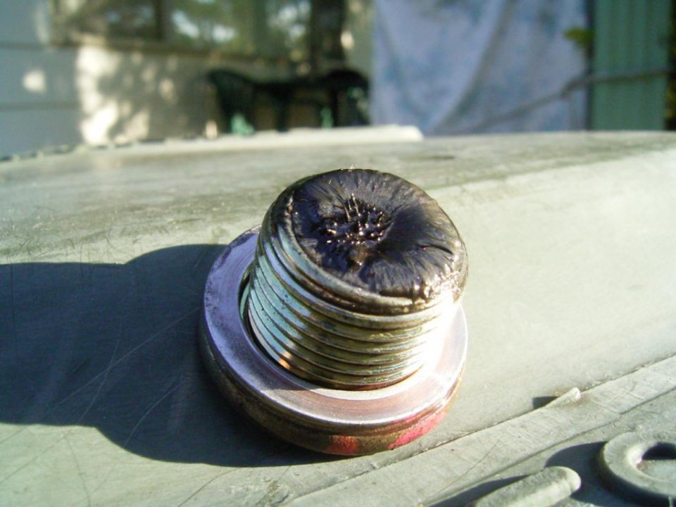

    When I changed the transaxle fluid last year on my v at 13k, I discovered that the Gen III eliminated the little ceramic magnet on the drain plug.
    So, I milled out a drain plug and affixed a 15 pound pull neodymium magnet to it.
    To see if it did any good, I removed the magnetic plug to find that there was already iron or steel particles attached to the magnet. I had half a quart of ws fluid left from the 4 quarts to refill what I lost in switching plugs.
    I have uploaded photos of the Gen II plug removed after many miles and my plug.
