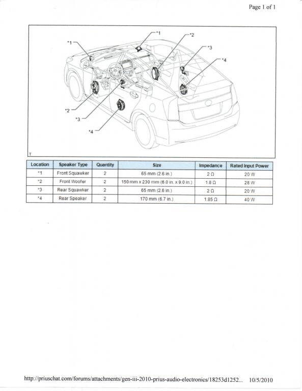

    Most find the factory supplied Nav system absolutely horrible, including myself, others do not. Then add the $200 for yearly update discs. It would be costly to replace the factory unit as this would require replacing the whole system. The amp and speakers use non industry specs. The cheapest solution is your phone or a Garmin. I ordered my 2010 II with base radio so the lost cost was easier. ShawnB2 ripped out his entire Level V system, he hated the sound and Nav so much, loosing his variable cruise, self parking and diagnostics "I believe". Do a search on him to verify specifics. Below are the speaker specs for the 2010-2011 JBL Nav and JBL non-Nav systems. After market HU's were not compatible with the JBL amp in 2010, though there may be an adapter available that "actually works" now, but I doubt it. Best wishes.
