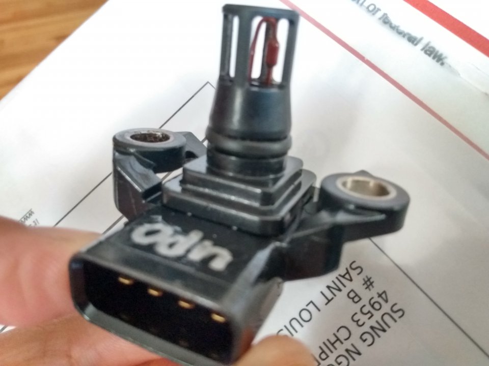

    Regarding the MAP sensor:
    1. There seem to be two styles. My (2010) sensor has a small plastic cage, and what looks like some sort of resistor within it. I've seen another locally, where there didn't seem to be anything to speak of in the cage.
    2. First time I checked mine it was practically swimming in oil, mostly delivered by the PCV circuit I'd speculate, and some spit-back from the intake ports. I wonder if that effects it's reading.
    And as you say, if one of the capillary EGR passages, say at cylinder #1, is near-totally clogged with carbon, ahead of the other 3...

    The ones with the red doodad have the -52010 part number:
    The ones without the doodad have the -47010 part number:
    The different part numbers were mentioned here and Elektroingenieur looked into the details here. It seems the doodad-positive ones were used in some of the very earliest production months of 2010 Gen 3, and the doodad-negative ones have been used ever since. Neither one is listed as a substitute for the other, so presumably whichever type the car came with should be used if replacing it. The doodad adds about $34 to the part.
    I don't think there's much to go wrong with the MAP reading. You can always read it with the engine off and compare it to your barometer (or the pressure reported on your local weather web site), or with the engine at idle, where it'll be lower, typically around 4 psi.
