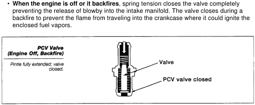

    Pcv valve was replaced as preventive maintenance and i was told the old one was shot. But explanation made me wonder. He said ”its one way valve but airflow could be applied both directions”. But isn’t pcv valve designed that way? Normally open.
    Mendel Leisk and Bill Norton like this.

    PCV valves have several tricks up their sleeves. Closing in the backwards direction is one of them.
