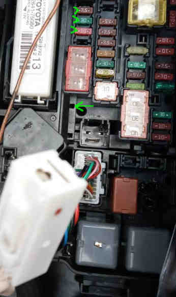

    The 125 amp DC/DC fuse buried inside the front fuse box is a nightmare to get access to. There are some accessible points where it can be easily tested with a meter though:
    That photo is from this post, which has more details.

    I did exactly what you guys said, check the voltage at that location, and nothing showed up
    the fuse (140A) at the 12V battery looked beat up but fine
    Those 3 small fuses (mine has 2) all did not show voltage (not videoed)

    That test point proves nothing if you don't first check power upstream of the 125a like the fuse box jump point. See diagram. The attachment in my post above shows you how to visually inspect the 125a.
