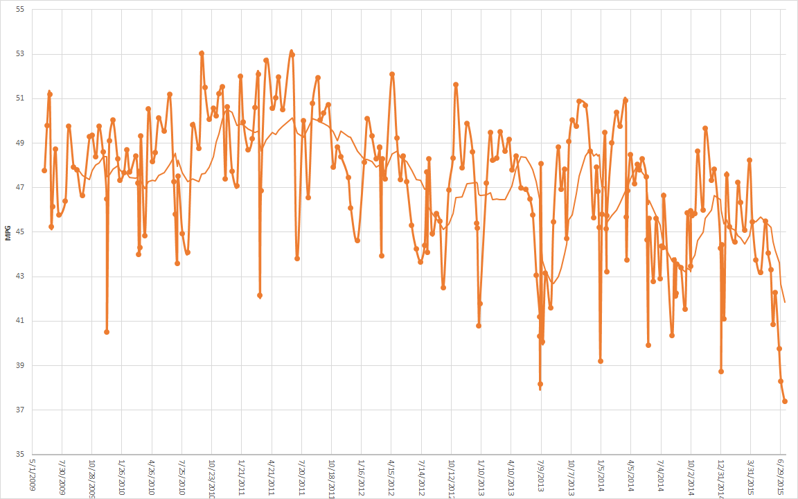

    I also have trouble with performance and fuel economy in the recent AZ summers. My 2010 has 82k miles. When battery temps reach above 122°F, things go downhill in a hurry.
    Are you tracking fuel economy (FE) with an app/website like Fuelly? I've tracked mine since the beginning of ownership, and the last 2-3 summers have been brutal on FE. Click through on the logo in my sig and find the lifetime graph. Summers take a huge dip for me.
    There's a few anomalous drops due to higher speeds or hill climbs, but you can see definite downward trends during the July-Sept periods each year starting in 2012, and more or less worsening every summer. This summer has been particularly brutal w/ the last 3 tanks below 40mpg at the pump.

    I've edited my post above to show trends that started in 2012, and have worsened every summer.
    Inlet isn't blocked, and I monitor the BT2 sensor (per ScanGauge spreadsheet), 45-46°C is when hybrid mode reduces, and anything much above 50-51 means a very sluggish time.
    I've seen as high as 58°C parked in the sun 1-2 hours after driving due to heat soak and chemical activity.
