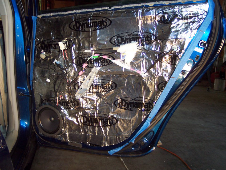

    I did this for each door, but unless you have a heated garage, it could be difficult this time of year: Pruis door Dynamat 001.JPG

    Did that Dynamat make a big difference phoenixgreg?

    Yes, the Dynamat in the doors made a big difference in road noise thru the doors. It's not an easy job though. It also made the OEM speakers sound better, IMO.
