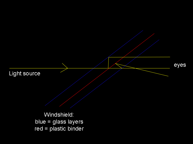

    Figured I'd update. I have asked several dealerships around my area and plenty of other Prius owners, and nobody has ever heard about this problem.
    I ended up going back to my local dealership (not where I purchased the car), and kidnapped the service manager right before they closed up. It took about a mile of driving at dusk, and a bit of explaining what to look for but sure enough he started to see my complaint with his own eyes. When we got back, he said he'd look into the issue, to see what he can do (some reason it wouldnt be covered under 3/36 but rather the CPO extended warranty).
    The sales floor was still open, so I grabbed a random salesman, and had him open up a couple of on-the-lot Pirii for me to peek through. Sure enough, none of them had the problem. I then "kidnapped" the salesman, and had him sit in my drivers seat and look at the streetlights of the Mercedes lot across the road. My explanations of my issue were drawing blank responses from the sales guy, but we quickly got our language straight. I had him look at the lights through the windshield, then tilt his head and look at the same lights through the closed window on the opened drivers door and compare. He picked up on the reflections much faster than the service manager did, and actually used some more colorful language to describe what he was seeing. Thats my kind of salesman. ;) I went back inside and took the back hallways around to the service managers office, and let him know the sales guy saw the same thing, so we're not all crazy.
    Fast forward a week or so later, after a couple unexpected visits to his office to check in, I got my answer last night:
    "Toyota is aware of the issue, and it will be covered completely under the 3/36 warranty, and will be fixed free of charge with Genuine Toyota glass."
    He then said something about windshield "inflections" or some random word I didnt pick up on, and asking him to repeat the technical term, caused him pause, as he could not remember the exact term either. I wasnt too concerned about the terminology he used, but rather the part where it is gonna be fixed. :D
    Using what I already know about light transmission (i play with a lot of lasers!), and windshield construction, here is a simpleton's breakdown of what is happening:
    Basically is boils down to this: there is a sheet of plastic in between the two layers of tempered glass that make up the windshield. This plastic layer if what houses the anti-UV and anti-IR "tinting", and provides the "glue" to hold the two layers of glass together should the windshield shatter in a collision. There is an occurrence where this sheeting is not properly oriented within the glass sandwich, causing light to enter, bounce back off the sheet to the outside glass, then reflect at another angle back in through to your eyes. Think of it as one of those old jukeboxes that has the two partial mirrors that reflect the light bulbs inside a bunch of times to make it looks alike a line of bulbs going way deep...
    Now, you dont see these reflections during the day, because the light source is the sun, which floods the car not only through the windshield, but through every other window as well, causing the "reflections" to be drowned out by all the available light bouncing around in your car. This also explains why the reflections begin to appear at dusk, and become more pronounced as the dark of night falls.
    Anyways, I've attached a couple thumbnails, one being the "light tunnel" effect I mentioned, and another crude drawing showing what is happening. Long story short, if you're one of the few experiencing this problem like myself in my 2013, there is hope, and there is indeed a fix that should be covered under warranty. Be persistent.
    Supposedly my dealership doesnt do glass work, but rather contracts it out to another locally owned shop (not a Safelite chain, but a professional local glass shop, thank God). I was told once the windshield arrives at the dealer, it will be turned over to the contractor, and they'll make an appointment to service the vehicle, then they return my old glass to the dealer, who then sends it back to Toyota as a warranty core. I think I will have the repairs done on the lot of the dealership, should there be a problem, everybody can see and immediately fix the issue.
    I will update the thread when this occurs...

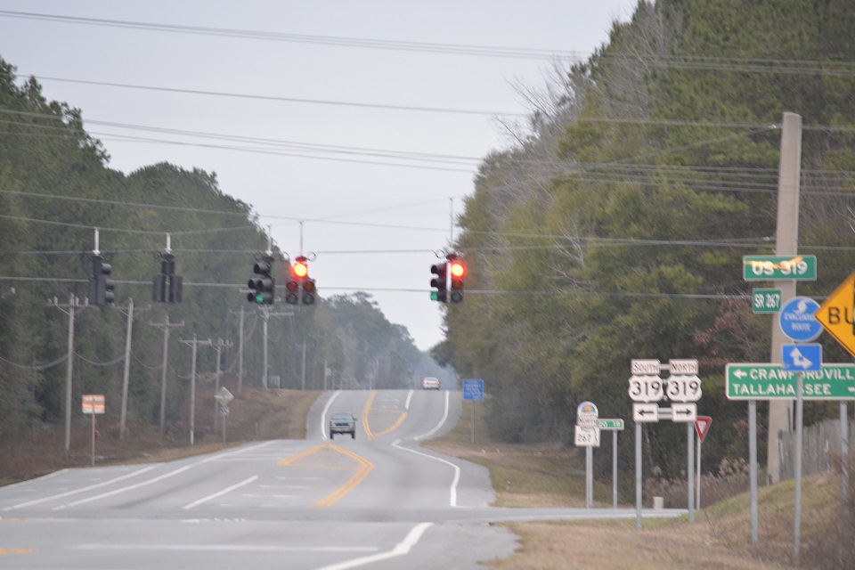

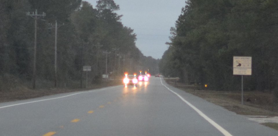

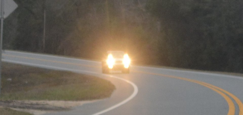

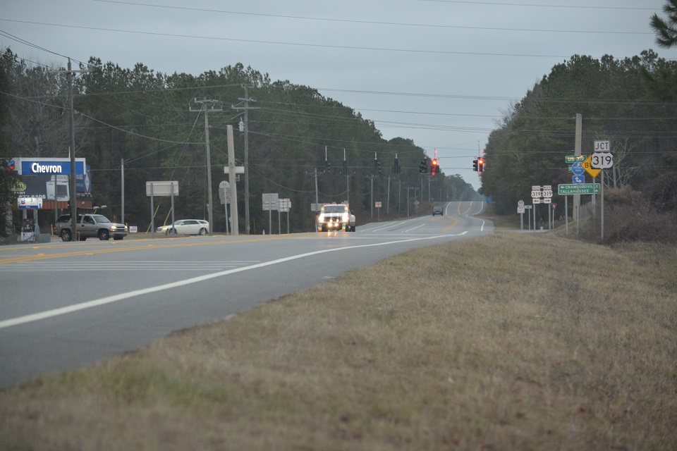

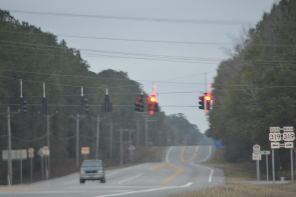

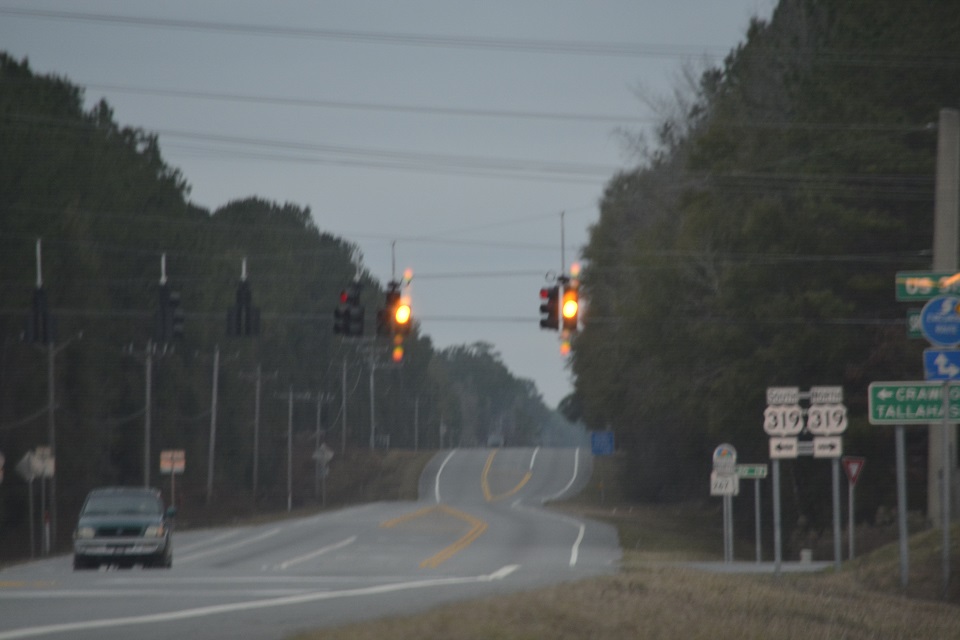

    I am sitting in the dealership right now, waiting for the glass contractor to arrive to actually fix my windshield. Its awful nice of Legacy Toyota in Tallahassee to provide these nifty desktops in the Scion corner of the showroom that are unblocked and free to roam the interwebz to PriusChat. :D Its also nice they left the door unlocked to the actual PC tower so I could stick in my usb sd reader to pull these pics off of my DSLR.
    Whats that? Yes, I took pictures. Since I had the appointment today, it got me motivated enough to take some photos of the "tripled images" that most folks simply do not see in their windshields, but is absolute hell on those of us that are forced to live with the defective ones. Only downside is these aren't at night, but early foggy morning, so the effects are not that dramatic, but are easy to see nonetheless. Hopefully if anybody else has this problem and getting nowhere with their dealer, maybe some of these pics will help.
    I had to grab my camera as the few oncoming cars rounded curves in front of me. Having my 35mm prime on the body made for wide shots, so I cropped the images to bring things in a bit closer.
    Let's get started shall we? Click any thumbnail to enlarge...
    First truck I encountered...look above and below the actual headlights for the "ghost" reflections.
    Next short line of cars...you can easily see the reflections floating above and below the actual vehicles.
    Off the side of the road facing the traffic light. The F350 dually is a monster for the reflections. Also take a peek at the red light itself...it has "ghosts" too.
    This is a view of the red light without the windshield...I opened up the drivers door, and stood in the gap.
    Back inside the car, a little more close in crops of traffic light action. Check out the ghosting on the yellow!
    Well, that's about it. I'm pretty much stuck here at the dealer until they get me finished, as my workplace is too far away for the comp ride, and it wont take long enough to deserve a loaner. I was told the contractor would be able to work me in before noon. Its 10:30a now...been here for an hour...1.5h-ish to go. Nobody is shopping Scions this early in the morning, so I think I might fire up Netflix on this "customization center". ;)
    When I'm completed, I'll provide whatever extra info I can gather to help further the cause. :D
