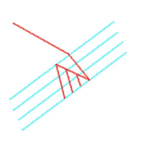

    Possible explanation - I have no idea if it is correct, but the optics is actual.
    Windshields are made up of at least three layers. It is possible that you are getting internal reflections off the glass/plastic interface.
    If the angle is slightly less oblique you get partial reflection.

    you're looking at reflections of light that has entered the glass through it's edge, not light that hit the surface. I think a more reasonable explanation is each layer of the windshield produces it's own mirror image. ever look at the inside or outside lights through a triple pane window in a house? same effect but even more exaggerated as the house window panes have a significant gap between them.
    This is totally a guess, but this is what I believe is exactly what I am seeing through my window since I see exactly 3 mirror images underneath any light source:
    What's odd on my window is some areas of the glass are worse than others. Some areas have more significant noticeable distortion/refraction that can even be seen even in the daylight. Also if I move my head just slightly lower the mirroring goes almost completely away. There's a band in the window unfortunately at my eye level where it's the worst.

    An edge is just a very short surface! :D
    It doesn't matter what it's called, both my image and yours show the same phenomenon. The important factor is the angle of incidence. The shallower the angle the greater the amount of reflection.
