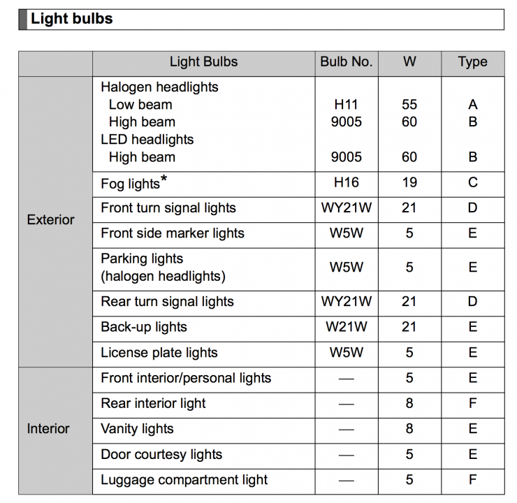

  7. pauerbach
    pauerbach Member
    Apr 10, 2013
    101
    34
    The 2012+ owner's manual clearly states they're H16 Prius Light Bulb Specs.png
  8. KeepitSimple
    KeepitSimple Member
    Nov 14, 2013
    128
    Oh sh@t. I knew I read it somewhere. Will h11 still fit? Work? Run into problems?

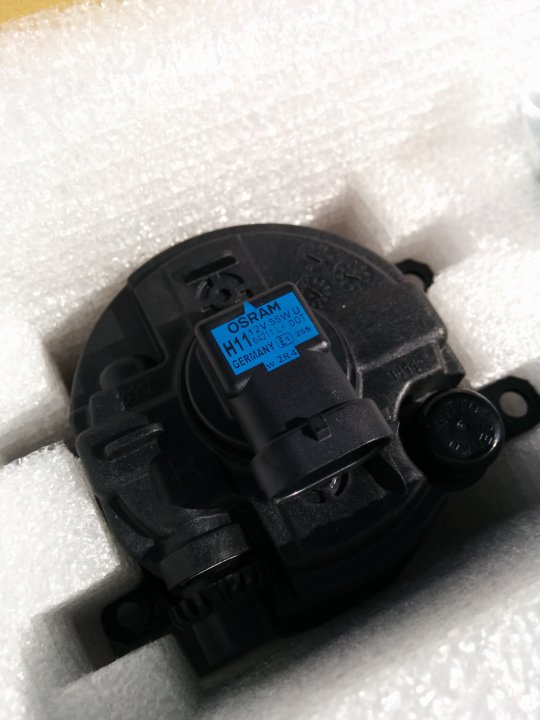

  16. CivicRydr
    CivicRydr Junior Member
    Sep 12, 2014
    San Francisco
    Just installed the 2012+ fog light kit and the bulbs are H11. See photos.
