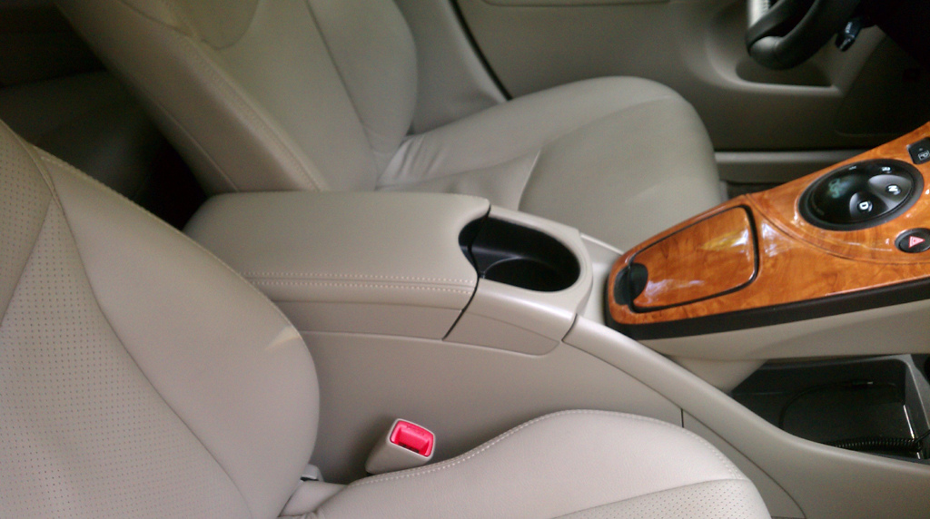

    lol...I hated my 2010 armrest so I installed a 2012..it's completely an even swap. Good luck in the junkyards..it took me 2 months to find one. Ordered a new leather top and painted the cup holder to match my bisque.

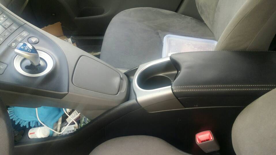

    Yes. I just bought the complete unit and installed last week.. The plastic is black not dark grey if u have the cloth grey interior.. I found the leather model.. Kinda 2tone.. Lower console is black with the uper console and cup holder is darm grey.. Not to bad looking.
