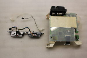

    What they do is covered in T-SB-0036-16, which in turn refers to the Repair Manual (more info) for the gritty details.
    You can see that what they do exactly depends on just how spectacularly your particular inverter happened to bite the dust.
    If it blew the side right out of its metal case, you get the whole assembly, around $2650, or $2200 at discount, if you can find a dealer selling one.
    If it didn't go quite that dramatically, they may just open it up and replace the intelligent power module (transistor kit), $1500-ish or $1100-ish at discount:
    or perhaps that and the MG ECU ($185 to $226).
    and maybe a couple other miscellaneous parts.
    Labor-wise, replacing the whole assembly is easiest. Any of the crack-it-open-and-replace-parts alternatives will be a much bigger deal, where you really hope the dealership somehow has a technician with experience in power electronics assembly because it's much more like that than it is like auto repair.
    Note: don't rely exactly on the part numbers I have linked here. In some cases there are different part numbers that have to be matched to the car.
