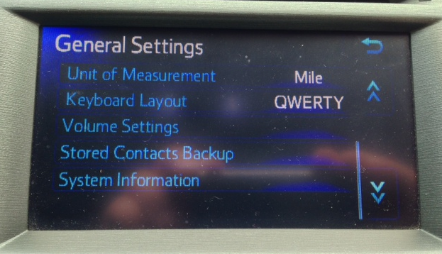

  14. Tracksyde
    Tracksyde Member
    Sep 21, 2011
    1,429
    762
    So Cal
    I'll just confirm what Gaudete is saying.. these screens and manual references you guys are posting are not applicable to the base PiP.
    I checked mine last night and under Setup->General, there is nothing about system time or any time for that matter. I didnt get a chance to look around further, but what I was looking through, I couldnt find anything about nav time.
    My nav time, however, appears to be fine. In fact, I plugged in my Home as a destination on my drive home yesterday just to see if my ETA time was correct and I didnt even see an ETA time (shows you how much I use the nav).
    You have to tap on the "time-to-destination" for it to switch to ETA time (meaning, by default, at least on mine, it shows '5 minutes' or however long it estimates you will reach your destination.. but if I tap the '5 minutes', it switches to '6:05PM', the ETA).
    Also, the base PiP's head unit is made by Harman, not Denso.

  17. Tracksyde
    Tracksyde Member
    Sep 21, 2011
    1,429
    762
    So Cal
    Ok, so after I posted that, I started second guessing myself, especially after I found this manual (on the Toyota website when searching for 2012 Prius PHV, the document is titled: Toyota Universal Display Audio System Owners Manual With Navigation: Setup Operation)
    http://www.toyota.com/t3Portal/document/omnav/OM33A02U/pdf/n08.pdf
    (turn to page 2 of the document, which is labeled page 197)
    There, in the 3rd image on the right, item #12, it shows a "button" for Daylight Savings Time.
    So after lunch I went out to take a look, again, and I took pictures:
    You'll see it doesnt match up with the manual that Toyota provides. This isnt the only thing that the manual is wrong about. There are others (such as the TPMS and being able to see actual tire pressures) (also, pushing the "down" arrow on the right just takes you back to the first page, which does match the first image in the PDF)
    In any case, it got me wondering how my head unit knows the correct time.. or maybe mine is just set for "Daylight Savings Time" so it is correct now.. but maybe it wont be correct come November? :confused:
    The other thing I was thinking was, maybe with some firmware update along the way, the DST option disappeared. I'm on Entune 3.1.0.
    When I leave work, I'll try changing the time on my dash clock to see if they are connected. I doubt it, but thats the only time I ever change/set. So we'll see.
