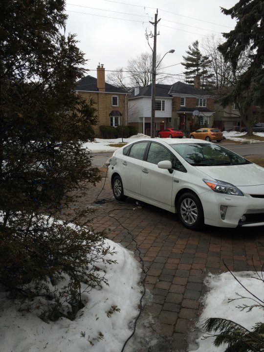

    Bought a 30 foot 12 gauge black extension cord, for CAD$60. Pricey. The 50 foot was actually 1/3rd cheaper, but was in bright pink. I don't think my wife would like a bright pink extension cord in front of our house. ;)
    Since there are no designated parking EV parking spots in workplace garage, I am considering buying another one to keep in the car.

    What's not to like: sounds like an umbilical cord. :whistle:

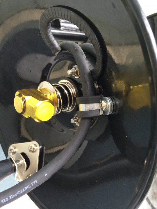

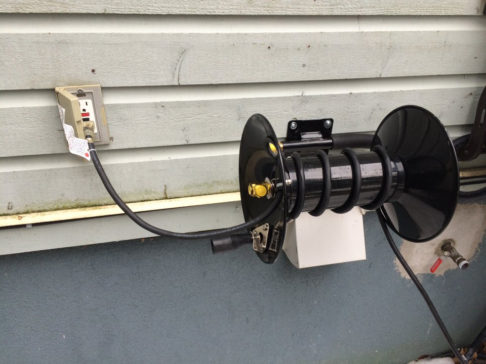

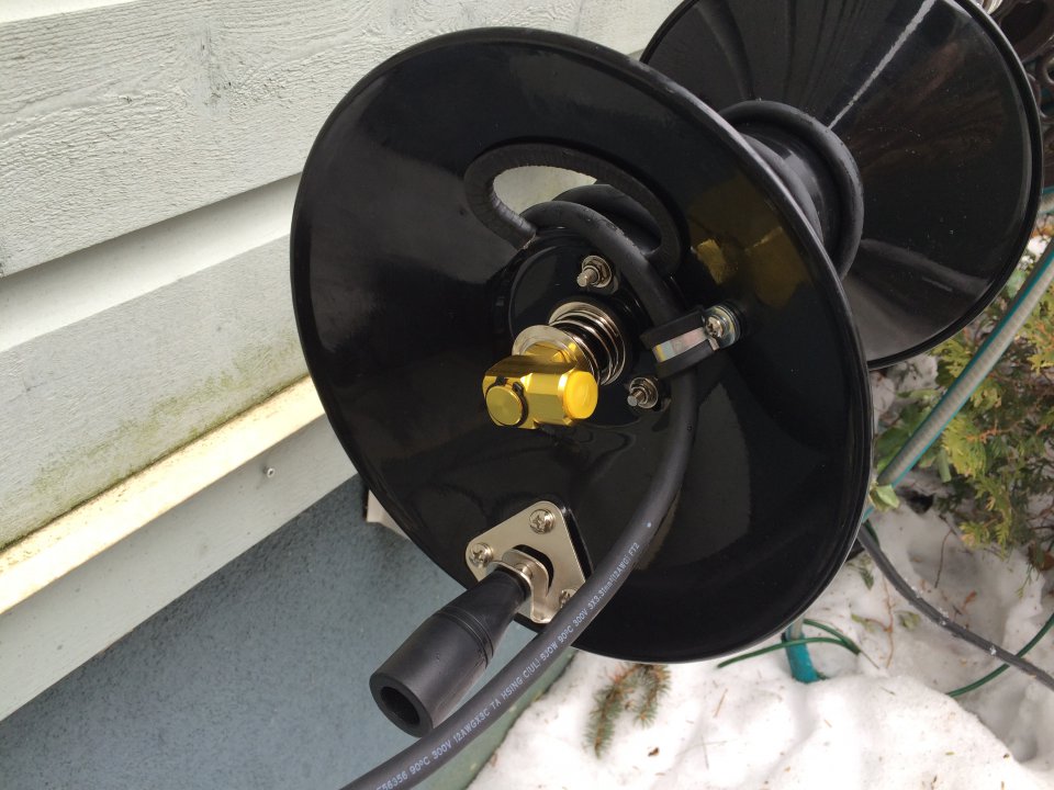

    I checked the labelling of the Toyota charging cord. It's 14 AWG actually, not the 12 I was expecting. A very thick casing for 14 AWG though.
    I was getting sick of putting away the extension cord every morning, and then unraveling and untangling it every evening. I couldn't find a 12 AWG cable on a reel, and the empty plastic extension cord reels at Home Depot looked rather flimsy. Plus the hose reels for garden hoses were way too big. So I went to a local hardware store and picked up a 3/8th inch air hose reel. Considering my 12 AWG extension cord is only 30 feet, a 50 foot reel would have been a better fit, but I got a 100 foot reel just because it was on sale and much cheaper (CAD$30 at Princess Auto). I unravel all the way to charge (to avoid heat buildup), so for this reason too it's better to get a long enough extension cord but not too long. (In case you're wondering, that white box is not a dryer vent, so no heat issue there either.)
    No idea how long it will last since its steel, but it is at least powdercoated so hopefully it will keep a few years before starting to rust out.

    well done!(y)
