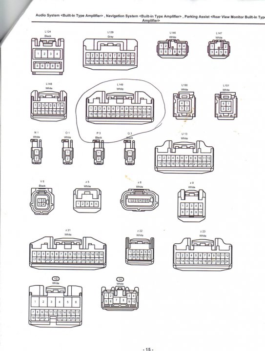

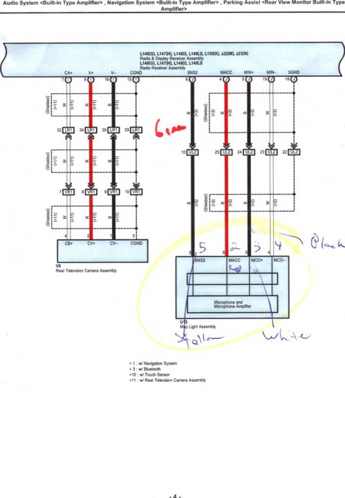

    Below are my notes and some pics on how I wired the microphone. I wired a four conductor shielded cable from the newly procured amplified microphone connector in the overhead cluster (shown in picture) back to the radio.
    Sorry for the delay in updating this thread , its been a while since I did this upgrade and my original notes were lost in my mess of a file cabinet :)
    Yellow wire on mic harness to pin 6 of l149 (28 pin connector on radio)
    Red wire on mic harness to pin 4 of l149 (28 pin connector on radio)
    White wire on mic harness to pin 5 of l149 (28 pin connector on radio)
    Black wire on mic harness to pin 19 of l149 (28 pin connector on radio
    Shield to pin 18 of l149 (28 pin connector on radio)

    That's awesome IMkenNY, thanks so much. That's EXACTLY what I was looking for. You rock! For this part:
    "Shield to pin 18 of l149 (28 pin connector on radio)"is there a metal shield inside that black outer coating that serves as a ground, or was that coming from somewhere else. Your posts on this and the backup camera were awesome. I did the exact same thing and they are working beautifully.

    I didn't see a shield connection on the short microphone lead.
    The cable shield to pin 18 on the radio just shields the long cable run from interference as you run it across and down the windshield.
