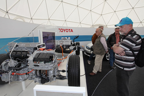

    Looks like a fun project!
    I'm interested in seeing if you can actually drop that whole cradle assembly in one piece. I've been wondering this for the last few months ever since I saw those two guys body swapping onto Prius chassis (the Dodge pickup and the Firebird). I always saw pics online of just the drivetrain sitting by itself without a chassis (Like here on display at an auto show: [​IMG]) so figured it was possible do to.....and then basically all I'd have to do is figure out how to securely mount that assembly off the frame of a body-on-frame vehicle and mount the rest in back...like say an old classic Hilux that's sitting in my driveway :)
    Good luck!!!
