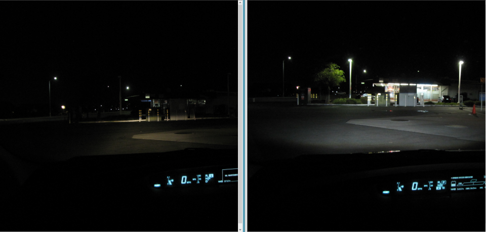

    Havent had a chance to do a real good before and after of my HID retrofit, but I think even this shot makes it plain.
  7. xliderider
    xliderider Senior Member
    Apr 19, 2012
    8,140
    3,277
    Honolulu, HI
    Looks like your aim is too high. The car seems to be in a slightly different position in the two shots, but the cutoff in the oem pic is near the base of the poles with the reflectors. The after shot, who knows where the cutoff is, because it's lighting up the whole other side of the street. That would be painful glare to anyone that's looking in your direction. Also, there is a dark area in front of the car which also suggests the aim is too high.
  8. fuzzy1
    17,898
    10,687
    I have to agree, that second picture looks like it will be blinding oncoming drivers, especially people like me who have aging eyes developing cataracts (surgery is still a long way off).

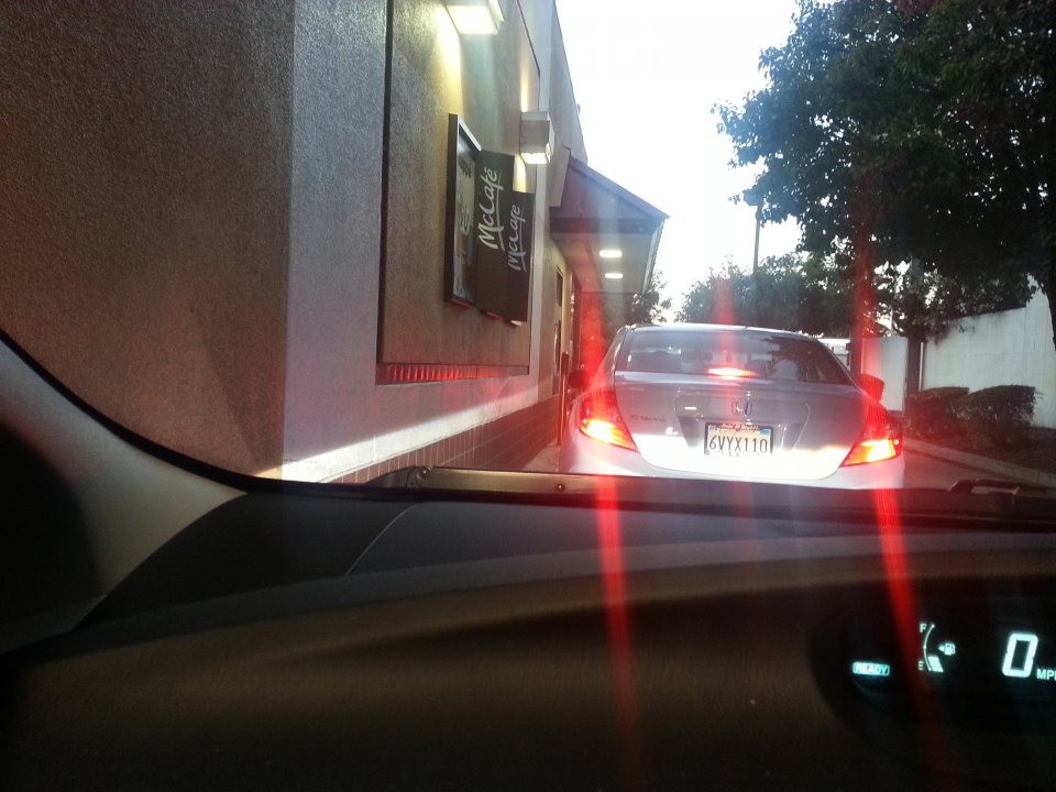

    Maybe this will help, you can see the light going under the mirror of the car in front of me.
  10. xliderider
    Apr 19, 2012
    8,140
    3,277
    Honolulu, HI
    Yes, much better. ;)

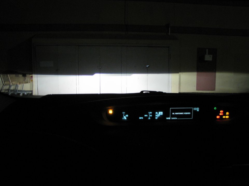

    no pattern, but against a wall
  13. fuzzy1
    17,898
    10,687
    The center of my headlamp is about 29.5 inches off the ground. If the cutoff were at 33 inches at 25 feet, that would mean the plane of the cutoff is rising, not falling. I don't believe that is legal in my area. It certainly isn't friendly to oncoming drivers.
