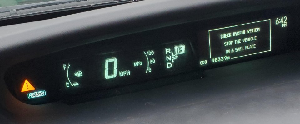

    Reporting in - a couple of days has passed and so far, my little hybrid turns on without issues (I replaced the 12V battery with a new OEM, and also replaced the key fob battery). Still need to replace the headlight bulb and clean the coke mess (tho, I'm thankful that it was a can zero sugar coke).
    However, the check hybrid system error came back on the second day. Not sure if it's coincidental or triggered, but I pressed door unlock button and immediately the message popped up on the screen. Anyhow, this error is nothing new - it came 2-3 times in the past and every time dealers couldn't find a problem and just reset it. I can drive the car normally tho (first time I was scared, not I'm annoyed). Nonetheless, this is still concerning and I'd like to solve the root cause. Here is the exact message (not mine, but aside from mileage, everything is 100% the same. My car has 155k).
    Can you please recommend the best course of action to pinpoint the problem? The fact that dealers couldn't identify any problem leaves me with little hope for resolution but at least I can try. I already found a recommendation to clean up the battery fan as one of the ideas.
    Please let me know your thoughts. As always, thank you so much (also, let me know if you think that this deserves a separate post). bmebc90bf4n41_cr.jpg

    Plan A: The very best thing you could do is connect the car to a laptop running Toyota Techstream software. That would be able to pull the trouble code (and importantly, any sub-code details) already stored by the onboard diagnostics.
    Plan B: A simpler and cheaper (though more limited) alternative is to connect the car to an android phone or tablet running one of several apps that can get at least partial data out of the car, even if they can't read all sub-codes.

    Thank you sir - ordered both types from Amazon - let's see which one is better and send back the slacker. Will update the post in a week.

    If I went to a dealer with that yellow triangle and that warning message showing, and they said "gee, we couldn't identify any problem", i'd sweetly say "oh, ok, would you mind giving me the trouble codes and subcodes that you read, anyway? Maybe they'll start to make sense later...".

    actually, I did that. I do have the report somewhere - let me find it. It's been a couple years (sheesh, time flies) since the previous occurrence tho, so I'd still need to obtain the latest info since the cause might have changed too. Thanks for the idea - I'll report back.
